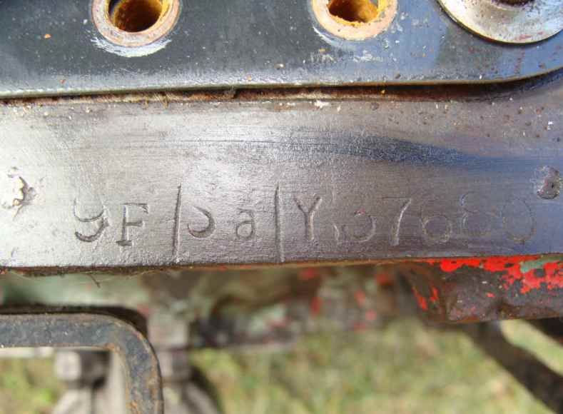

PostPosted: Tue Apr 22, 2014 7:30 am
Posts: 585
Location: qld
Hi
in my collection.. no idea of build date, however numbers for your reference
PostPosted: Tue Apr 22, 2014 12:22 pm
Joined: Wed Oct 23, 2013 7:10 pm
Posts: 163
Location: Hyde Park, SA.
This block looks to be about october 1965, so that would back up the theory that only the early (1965) cars were stamped with the lower case "a"..
Thanks for the info!
