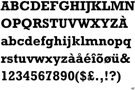

This is the closest I could find. Its called Rockwell Bold and is pretty much identical to the font used by Morris before the BMC merger. It was mainly used for things like titles in brochures and the covers of manuals - sort of a corporate identity. I'm pretty sure this font was used on the Morris Minor badges, then the Morris Mini got a slightly squashed bolder version of it. If you're keen you should be able to use it as a starting point and squash it a bit. At least it shows what a W would look like.
Try COOPER BLACK which comes standard with Microsoft word, its pretty close

This txt style it should be the one. Clarendon Text Bold SCOsF

I reckon Blackoak Std is the closest I've seen - http://fontzone.net/font-details/blackoakstd - go to preview, and type in MORRIS. The R's need their tails cut off and the rest of it fattened up, but it's pretty close
