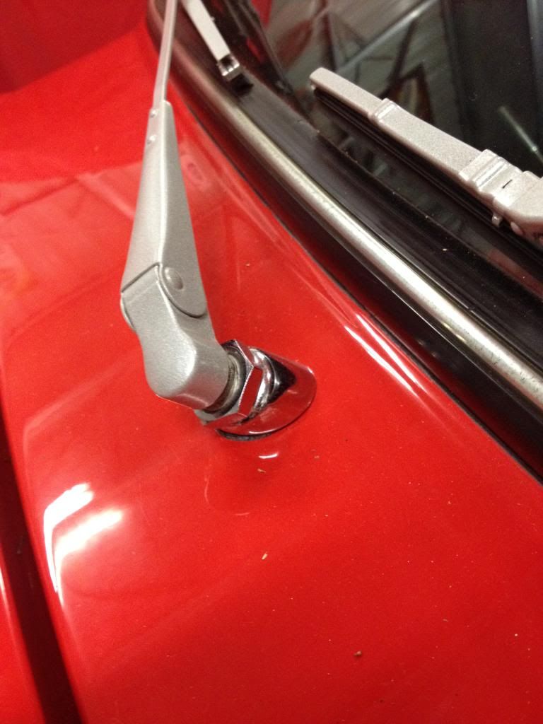

I can't remember where I bought these from? Mini Kingdom? Mini Car Clinc?

That is an early car with the UK style bezels. Have been available for many years, unlike the late type- Mini K, Mk2S, `Matic and Clubby ones. Which are shorter, wider and different angle.
HDPE machined late Oz ones-
Last edited by drmini in aust on Sun Jun 15, 2014 6:48 pm, edited 2 times in total.

My car is a 67 Matic.
