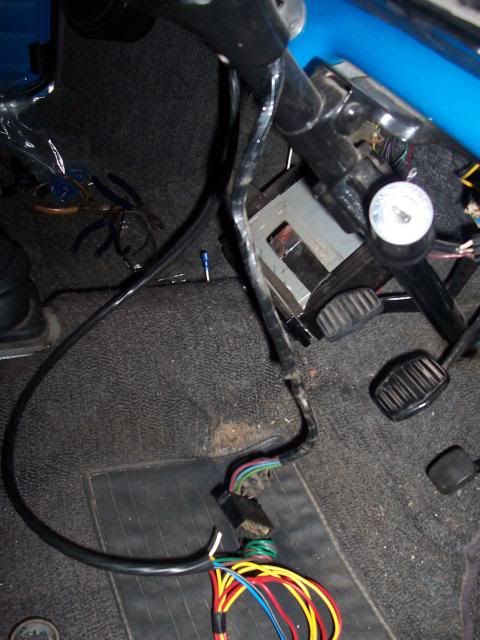

Now to set up the relays for the H4 headlights (low and high beam), if I split the wires coming straight out of the steering column for the low and high beams;
Splice into the wires before this joining plug.
Will this work, using the wires coming from the dipper switch to the switch feed (85) on the relay and then going from the + power outlet on the relay (87) back to the headlights?
