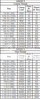

Stud bolt torque is limited by coarse thread which is screwed into cast block, standard 8.8 3/8 fine thread bolt is good for 49 , refer chart, wheel studs are no different. M :-)

For what it's worth, the Mini factory workshop manual (TP832) specifies 42 lbs/ft for the road wheel nuts, so that's the limit I'd be using.
