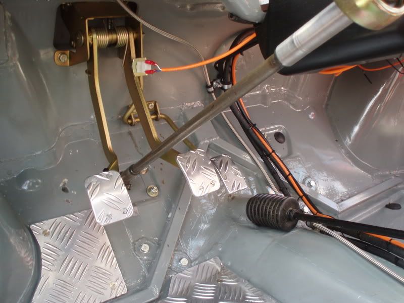

I've noticed lately that I can feel the subframe moving under my feet when I drive my car. I checked the bolts the other day and all were tight, except for the two under the pedals so I retightened them - however I can still feel the floor flexing a small amount when driving around (when not wearing shoes).
Last time I checked the floor and frame were solid in that area, though it's been a while so I'll clamber under for a look on the weekend.
Is the normal? If not, could it be related to the dual engine stabilisers I have connecting the sump to the bottom of the subframe?
(car is a 68 model, with dry front subframes)
Thanks.
:D

Well I finally pulled up the carpets and climbed under the car for a look - no cracks in the subframe or body regions, which is good. I then checked all the nuts for tightness and though not movable by hand, with a spanner on them the tower studs moved more than I'd have liked - so all tightened up now to something far more solid.
I also replaced the washers on the floor mounting bolts with bigger ones as the ones I took out have deformed in shape a bit.
Took the car for a drive and no movement now - all fixed.
