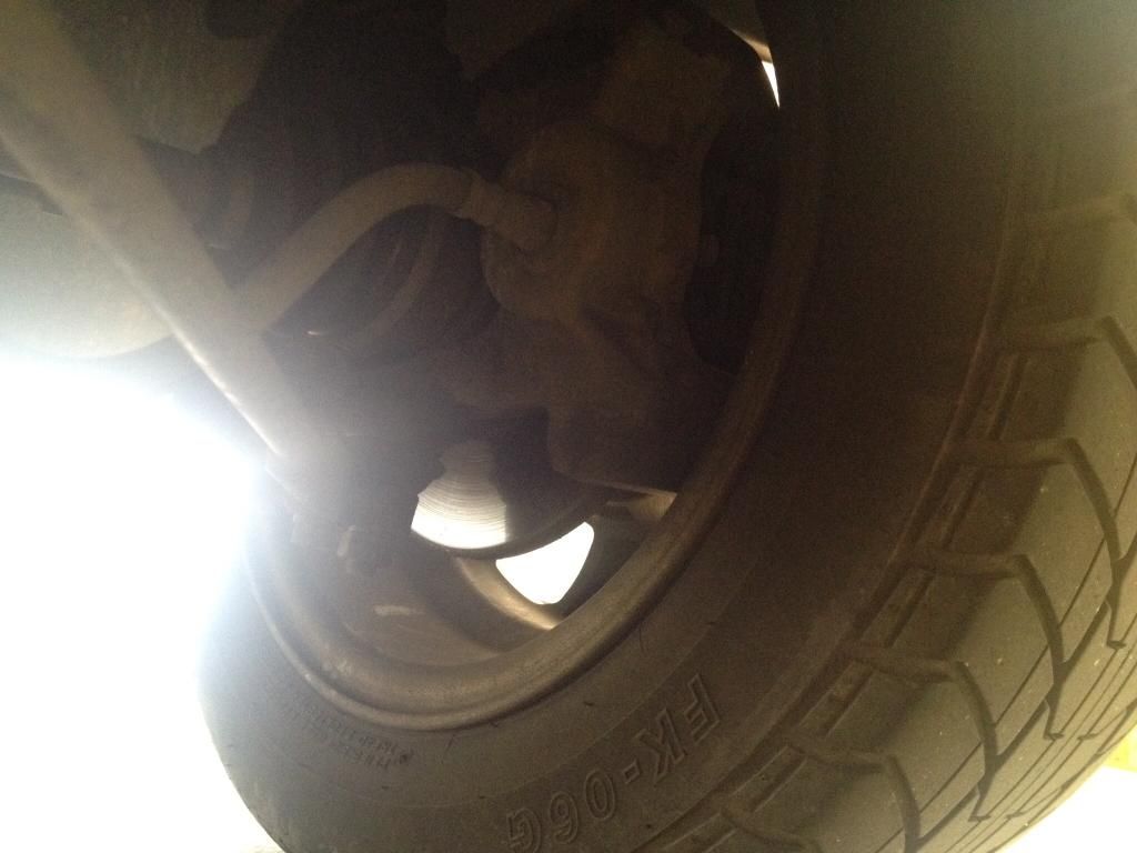

Rims are 12 inch, not sure what the brakes might be?

Mini discs. Possibly 8.4's

Thanks scoop, I was hoping for 7.5's
 Post subject: Re: 68 Deluxe
PostPosted: Wed Jan 28, 2015 7:56 pm
Posts: 1143
Location: Tassie
You would have been able to tell by taking a wheel off and looking at the drive flange. I'm basing my view on the lack of clearance between the caliper and the rim. Would think there would be a little more if 7.5s

If the wheels are 10inch I really doubt that they will be 8.4s as you need 12inch wheels to fit 8.4s. My guess is that you have 7.5s
