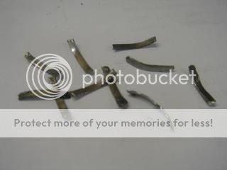

I did a oil change today on race car, found some bits that shouldn't have be on the end of the sump plug, I need some help determining were they came from, I am thinking needle roller cage ??? drop gears ?? :?: :?:
All the pieces are the same length and width :cry:

Im thinking gbox input bearing cage.
Not good tho. Looks like your in for an engine removal shortly

Could it be the ring that goes on the outside of the main double row bearing?

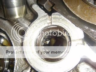

Well I have finally had time to pull the race engine, the inboard drop gear bearing was the culprit, luckily no damage to idler gear shaft or casing. I have brought new swiftune roller bearing drop gear set, that should stop it happening again.
