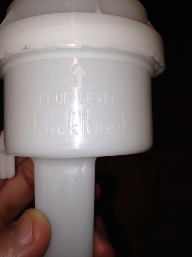

Got some Repro M/C reservoirs today off of Matt Reed.
Cheeky bugger put his name on them!!!!!! Hahahahahahahahah Nice work.
 Post subject: Re: Master Cylinder Kit
PostPosted: Thu Jul 17, 2014 7:17 pm
Ha!
