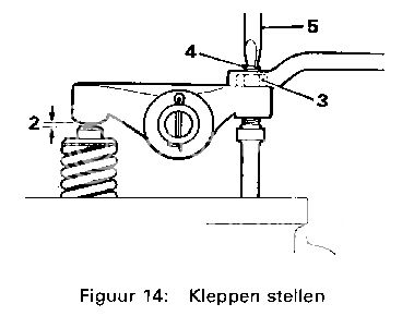

just to add to Irish's post there...
You adjust the gap marked '2' in this photo :
Using feeler gauges and spanner and screwdriver as shown.
