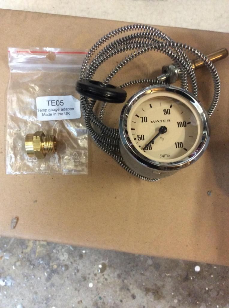

I am going to install a mechanical temperature gauge on my daughters and my mini's.
The adaptor below is a parallel thread and I am not sure how it is to seal in the head.
Do I just screw it in till it stops, use thread sealant or does the head have a tapered thread in it ?
The rest should be straight forward other than I don't have a hole in the fire wall big enough for the grommet that is supplied on the capillary line.
Any advice would be appreciated.

It will screw straight in (if it is the right thread), and a little bit of thread sealant never does any harm. Stag or a similar sealant goes well.

I measured the OD of both the electric temperature sender and the mechanical adaptor ant they are both 5/8" so it should screw in OK.
My dad introduced me to STAG when I was rebuilding engines in the early 70's (Brabham Torana) and I have used it successfully ever since.

Just a note, I've had the bulb contact a part of the head as it goes in. I didn't realise what I was doing and it deformed the bulb a little.
I don't think it affected the operation, but I guess it should have by reducing the internal volume of the bulb. Anyway, watch out for that.

I'm about to install the exact same gauge into my deluxe. With the adaptor it's a direct fit. Even when using the electric sender I use a little Loctite on the thread to ensure it doesn't leak.
Stuck the sensor in a heated saucepan of water today, and comparing it to an infrared temp gun it's more or less spot on!

Mick, not good...the aim should be to have the bulb sitting in the coolant flow and not fouling any part of the head or block (depending whee you fit it)..."deformed" may mean you have effected its operation or calibration.
I would be doing a trial fit and measure without the adaptors first to see how deep you can insert the bulb. Then carefully insert into the adaptor (some plumbers tap on the threads is OK) and add spacers under the bulb thread or adaptor if necessary.
