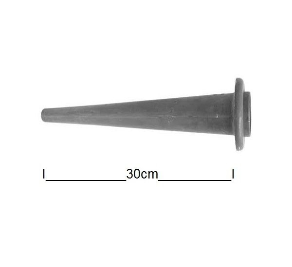

My car sits low. Sump is 8cm off the ground. Axle to wheel arch heights are about 260mm except for the rear left which is 10mm lower. It has Hi-Los on the front but not on the rear. Just want to confirm that the trumpets haven't been cut down. I measured the rear left at 300mm from the cone boss to the knuckle end. Can anyone tell me if this is the standard length. Picture to explain it better.

Yeh thats about right give or take a few mm.

Remember it is about 5:1 ratio on the rear so a 20mm ride height difference is only about 4mm on the trumpet (or hi-lo if fitted)...
