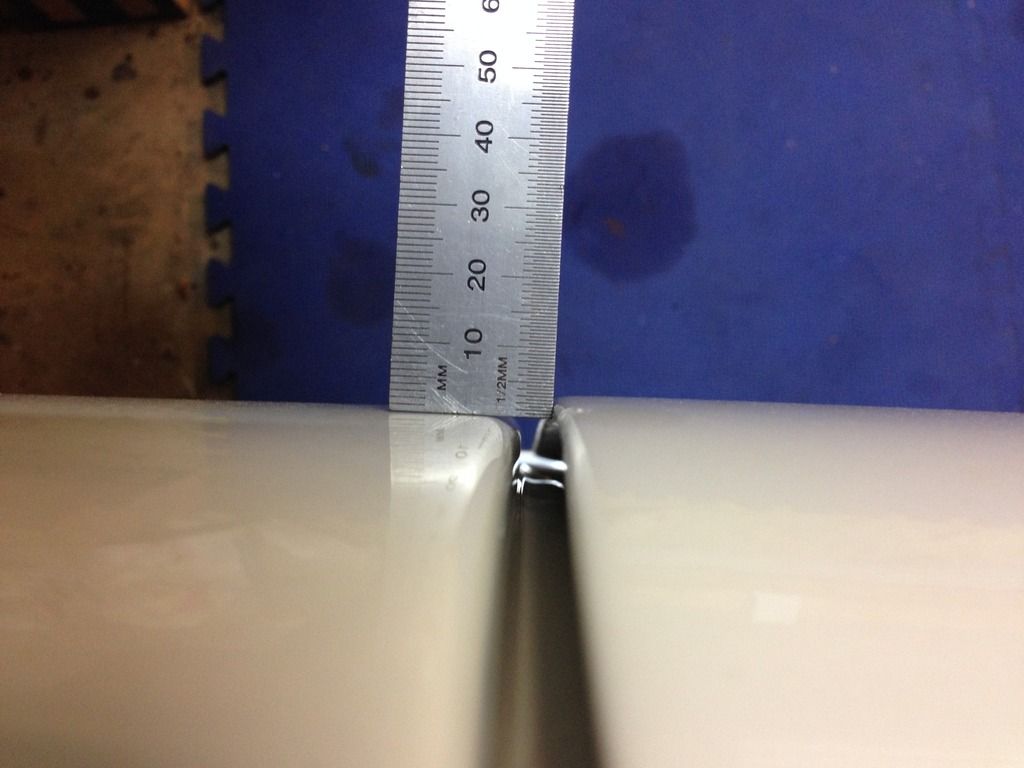

Now that my car is registered and driving well the things that I ignored previously are becoming annoying.
Both doors do not line up with the rear guards.

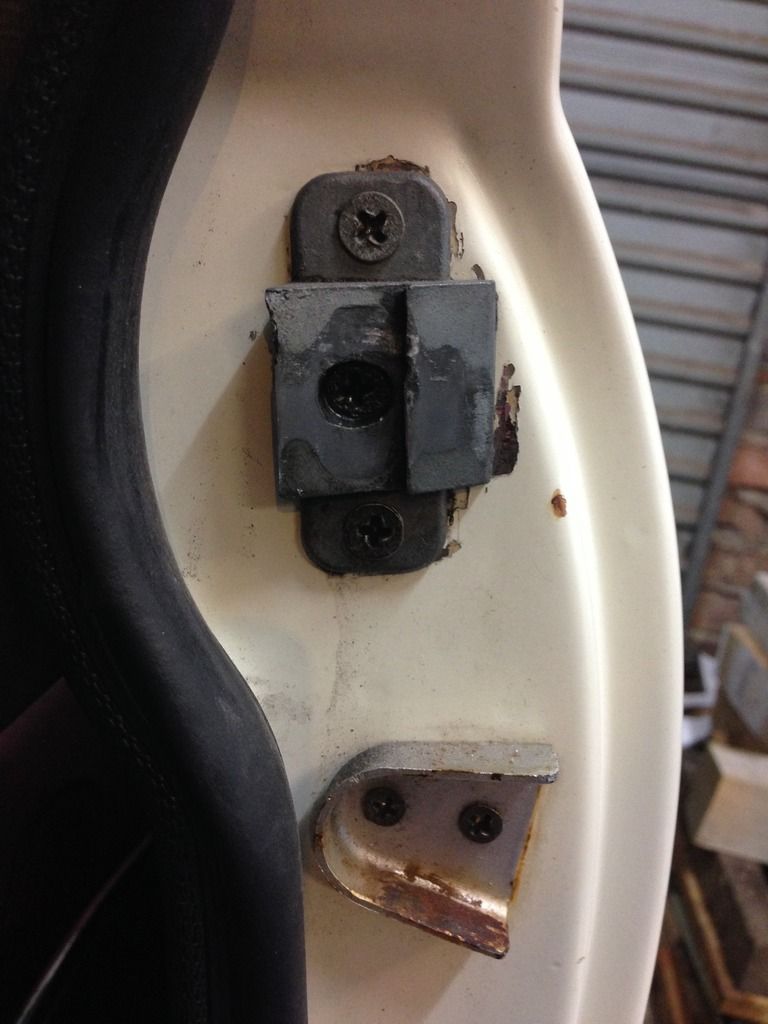

I have adjusted the catches in as far as possible, and also the door guide.
The catches are a little worn, about 1 to 2mm but this will not give me the 3 to 4mm that I need.
The lock tongues are not worn, so this is OK.

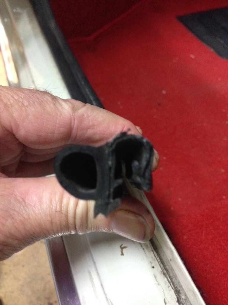

Here is the door seal that is fitted.
Is this the right seal :|
Other than belting the seal mount around the door frame in :( what are my options :?

Phil - your car is one of the best I've seen for door alignment.
Just leave it knowing many are worse! :lol:

I just looked at the Minispares site and they suggest this
http://minispares.com/product/Classic/B ... 0to%20shop
This should cure the problem I have along with new catches. Maybe :|

Could just remove the rubber seal on it now and see whether there is any difference, save you forking out on new swals that may not be actually needed

Incorrect door seals sliding window seals are a smaller section Karcraft, minisport list them

I have an 850 seal from minisport UK http://www.minisport.com/24a1351-seal-d ... mk1-2.html but it is a hard as :( ,way harder than the on currently on there.
Are there different versions of this seal. Needs to be a super soft one.

I'd try the 850 seals from Karcraft or minikingdomonline.

I might take my sample along and see if theirs is significantly softer.
The one I have from minisport UK is 24A1351. Minispares and minisport AU list the seal as XGA9934 ?

Kc lists it as XGA9934.
