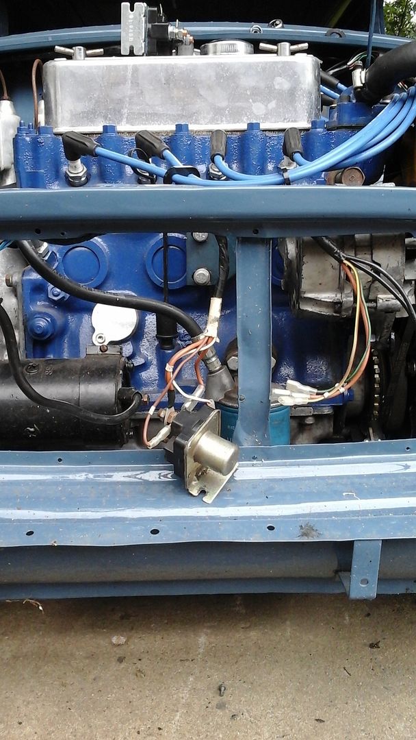

Hi, previously my solenoid was located up next to the engine steady, however i have put a new mk2 cooper wiring harness in my van and the wiring for the solenoid drops down between the alternator and starter. Just after some photos of where i mounts to thanks
PostPosted: Fri Apr 17, 2015 12:52 pm
It was never mounted there on Oz cars. That wiring doesn't look right.
Early cars had it on the clutch housing, later ones had it on the steady bar bracket like you had before.
Where did you buy the harness from?

[quote="nicholasatkins"]Hi, previously my solinoid was located up next to the engine steady, however i have put a new mk2 cooper wiring harness in my van and the wiring for the solinoid drops down between the alternator and starter. Just after some photos of where i mounts to thanks
The normal mounting position for the solenoid is above the bendix gear end of the starter motor, on a bracket which is fixed to the flywheel housing at the point where there are two tapped holes.

Got the harness from vinwire everything else is stop on.
PostPosted: Fri Apr 17, 2015 4:21 pm
Joined: Mon Jan 12, 2015 10:59 pm
Posts: 985
Location: Holt ACT
It looks to me like you have the harness too far around the front of the engine. Try pulling it back along the inside front guard.

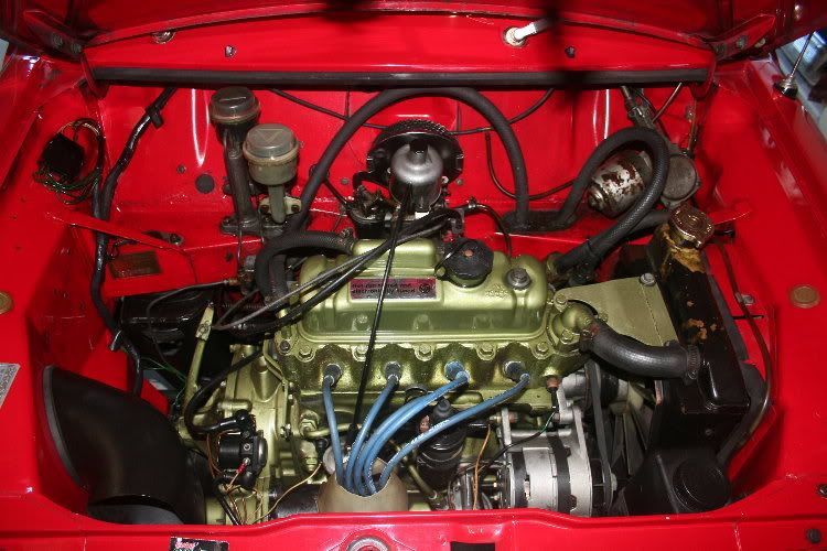

PostPosted: Fri Apr 17, 2015 5:06 pm
Posts: 3166
Does this help?
There is a triangular bracket which mounts to the clutch housing
1969 Cooper "S"
1967 Mini Deluxe
2019 MINI F55 Cooper S

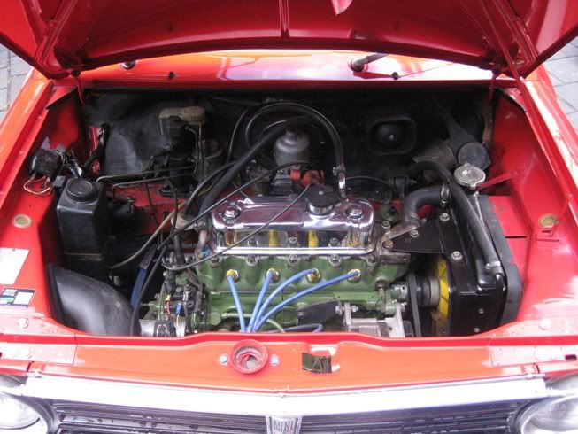

PostPosted: Fri Apr 17, 2015 5:10 pm
Posts: 3166
Or this version
1976 Clubman
1969 Cooper "S"
1967 Mini Deluxe
PostPosted: Fri Apr 17, 2015 5:15 pm
Posts: 3166
Or a 1973 Clubman
1969 Cooper "S"
1967 Mini Deluxe
