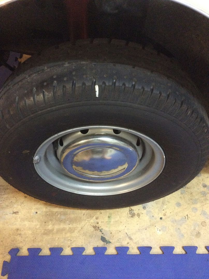

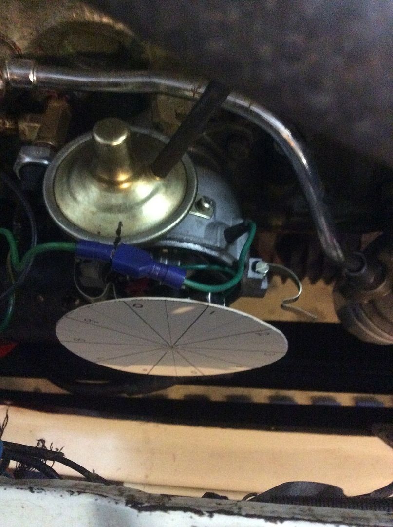

I have found out what my diff ratio is but would like some feedback on the process I used.
As I don't have a tachometer or an accurate speedo and didn't want to pull the engine I did the following.
With the car in 4th gear and jacked up on one side I can turn the wheel and with an indicator on the distributor rotor I could count how many times the distributor rotates. Easy :D
Because you are only turning one wheel the differential will halve the ratio !
Because I measuring at the distributor it rotates at half the engine speed !
So, if I turn the wheel 4 full rotations, i (or in this case the wife) could count the number of rotations of the distributor and I would have exactly the diff ratio 8)
Indicator marked in 18 degree segments (0.05 of a rotation).
The wheel marking point to count its rotations.
4 wheel rotations gave me 4.15 rotations of the distributor so I have a 4.15 to 1 ratio, right :|
Are my assumption correct :?

Just wheeled along the driveway and two wheel rotations gave 4.05 at the distributor so allowing for parallax error both results are pretty close to each other.
