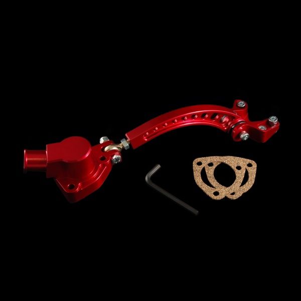

DSN Classics (UK) make a range of beautiful billet alloy, adjustable engine steadies for Minis. http://www.dsnclassics.co.uk
Here's a shot of a pair fitted to my car.
