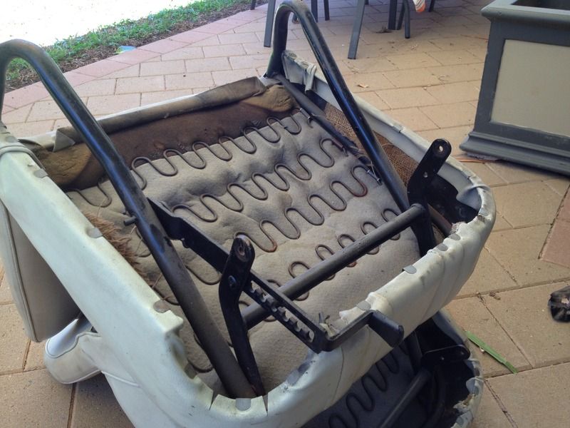

The bottom of these seats that I bought dont seem to look right to me????
Why do they have wire springs on the base? No rubber squab base? Is this normal??? Its been a while since Ive seen low back mini seats....
So there is no need for this item:
http://www.minispares.com/product/Classic/CZH3508.aspx
Also both chairs have this cut out section is this normal?

Steve Justminis told me these are later seats like Mini K etc. So that saves me needing to buy that rubber squab mat for the base.

My mini K seats have the rubber base

I think the seat springs changed depending on availability from the suppliers.

I prefer the wire springs, at least they won't break.

These are GT seats

I have a feeling that the seat quality changed in 1968. They seemed to try and cut costs right through the model range at that time.
