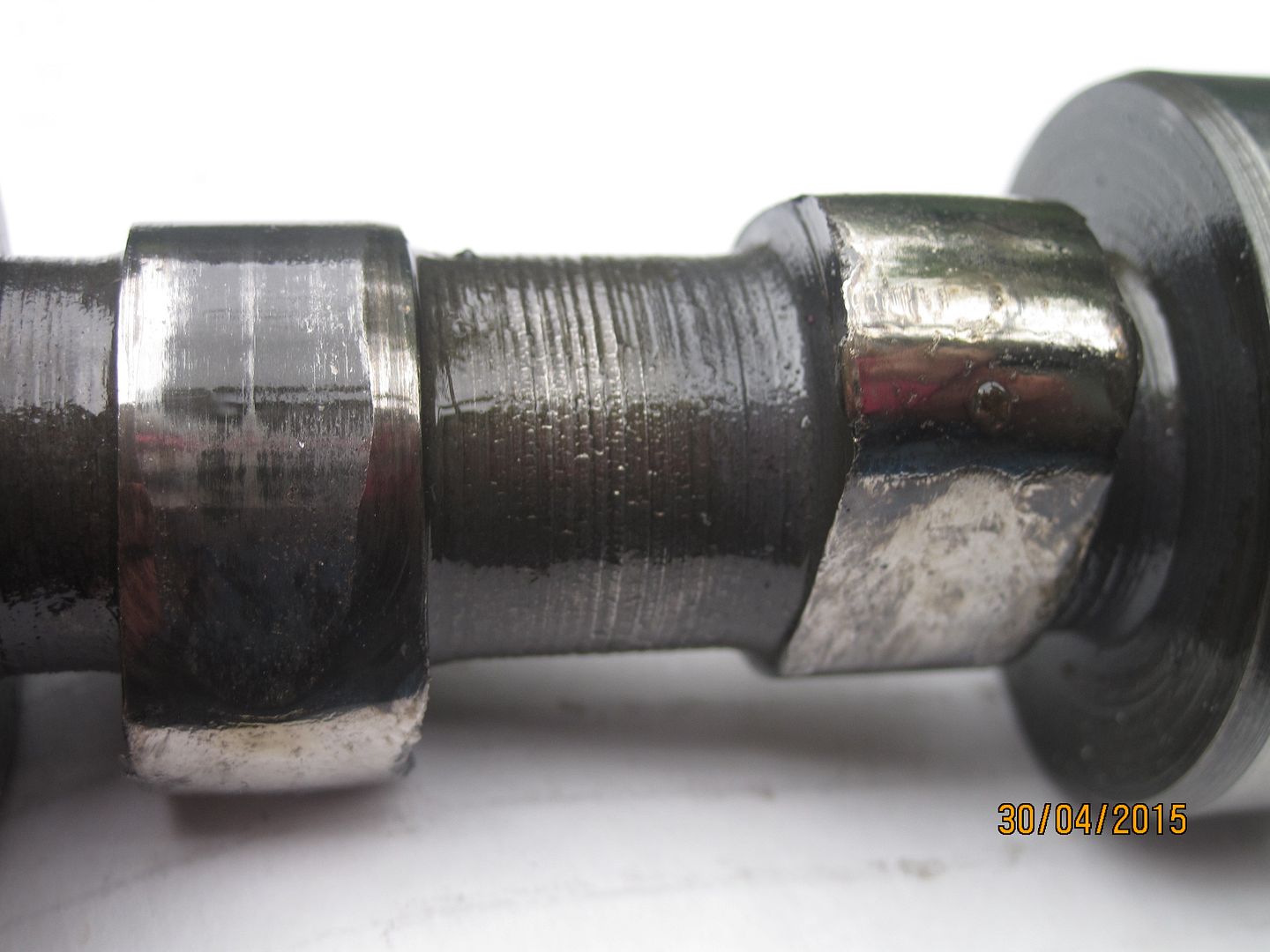

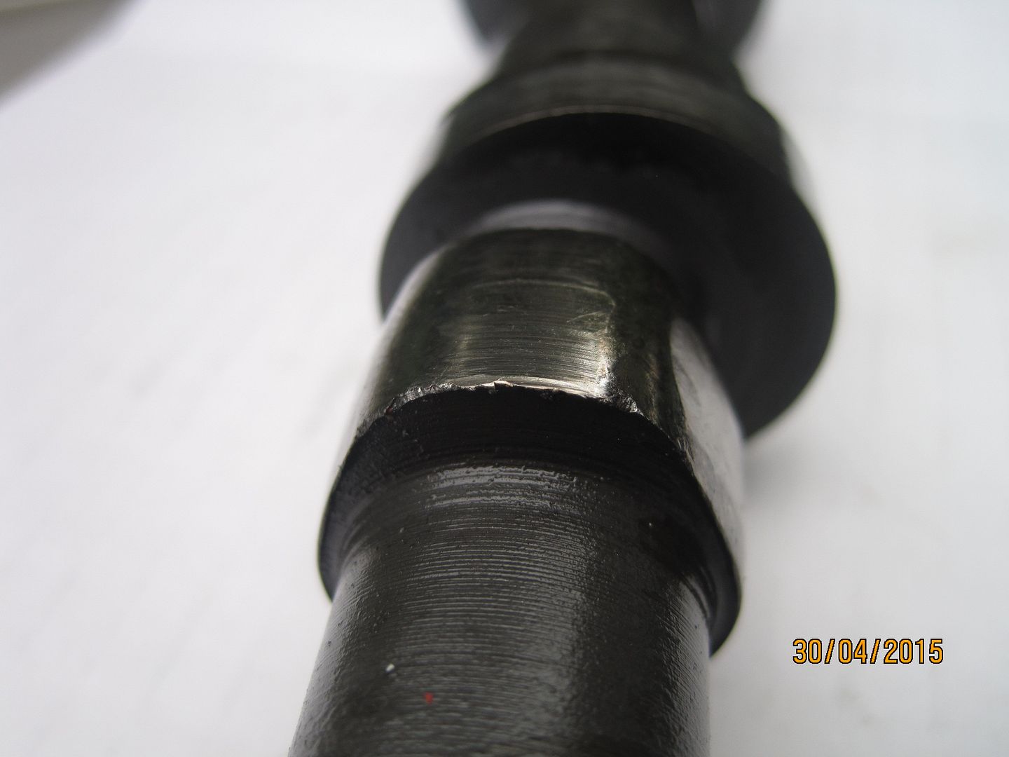

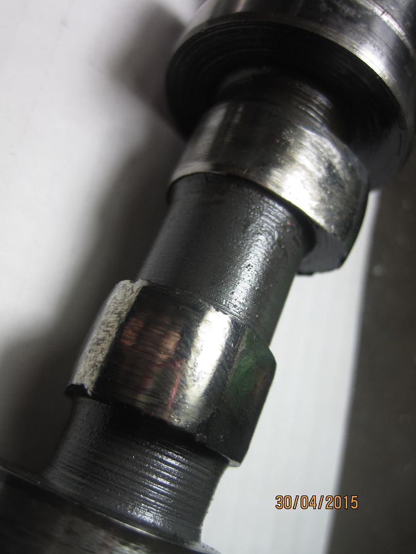

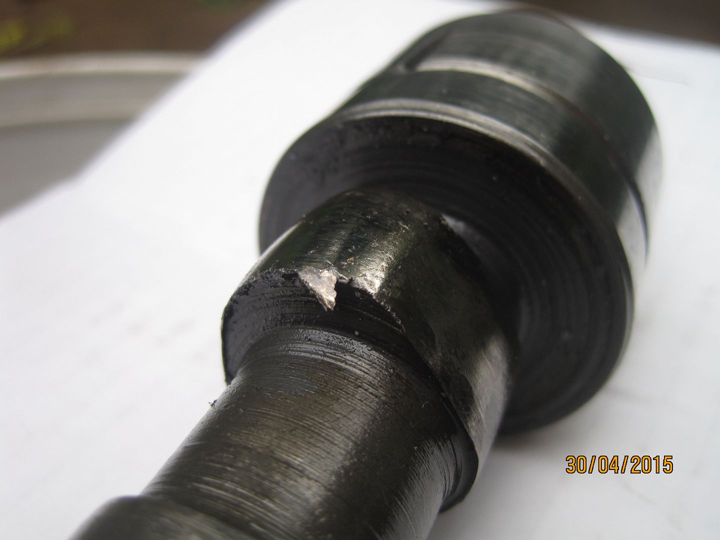

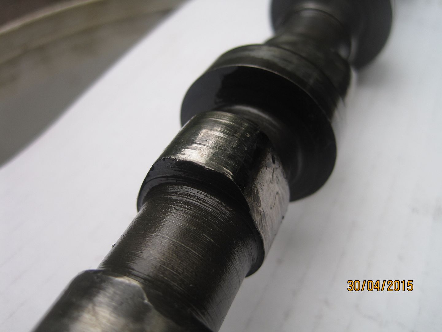

Hi All,
I don't have to say much. Please grind your Cam Followers.....
He thought he was putting the best of everything in it, this is the result after a few thousand kilometres. :cry:
These cam followers weren't Kent followers, they were a lightened follower that most people use in their motors.

An additional question sort of in the same ballpark.... I see mentioned that a hardness of 55-57 Rockwell Hardness is recommended for lifters. Does a reground cam need to be heat treated to match this or slightly exceed this figure- but whilst asking this, i doubt hardness played any key factor in this scenario.. ouch

What do you think post mortem is Graham?
No radius on followers and no rotation, or hardness issues as well?
Were the spring pressures OTT?

PostPosted: Wed May 06, 2015 11:02 am
The surface looks like it shatters like glass...
PostPosted: Wed May 06, 2015 1:13 pm
Surface is white iron, hard as. (lifters are cast iron, chill cast on the end).
