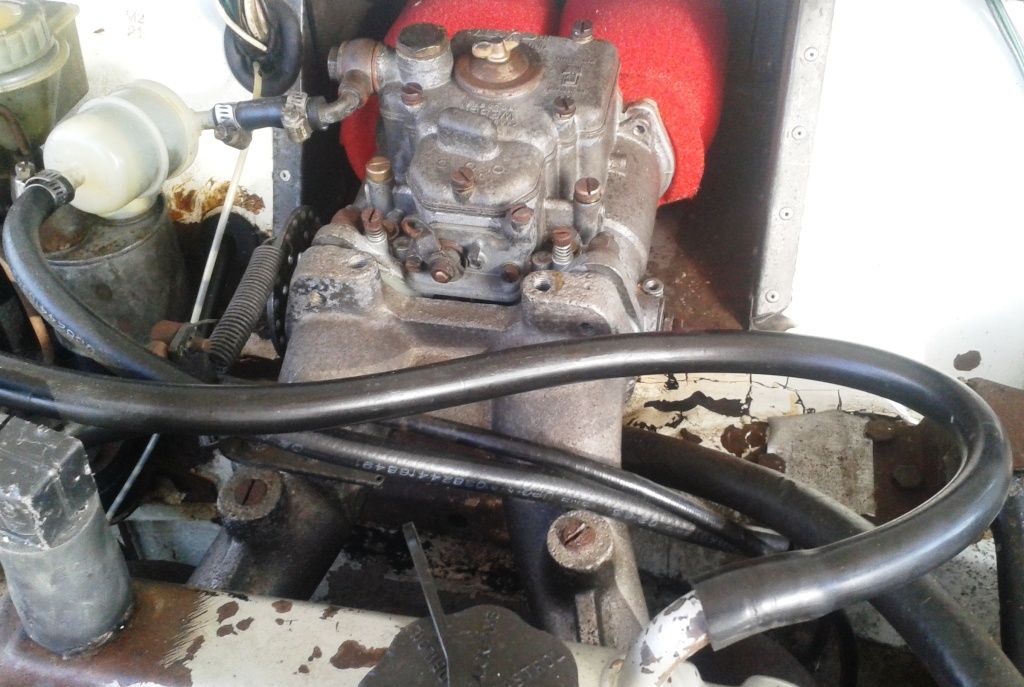

All done. They were 1/4 BSP so I just used a couple of air tool fittings.

Exactly why I went with the 2 ports.
Its slowly getting there. It used to have a 5L oil bottle as a catch can. Now it has a charcoal canister for a more standard look. The hoses I used were left over from my sprinkler system and hold water pressure fine.
