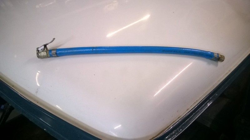

Thanks for replies, I will have a go at releasing hydro fluid with this tyre inflator.

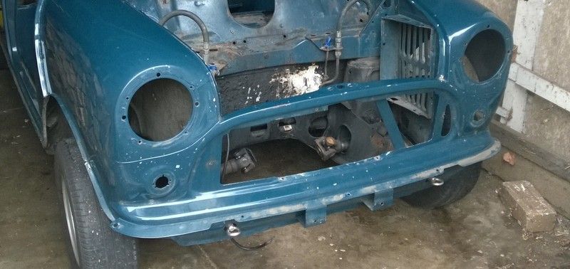

Yes, colour is Indigo blue / snow white roof which I will be doing again. Here it is in different light.

Sweet image. A foggy Essendon morning?
