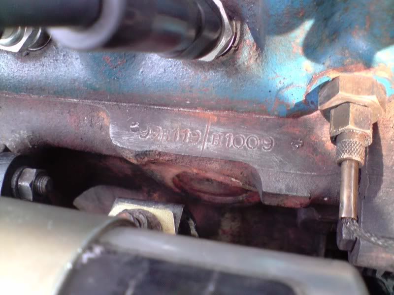

hey JT
my 68 Mini Matic is a metallic type gold colour too - hard to tell from this pic maybe, but the engine number matches with the compliance plate etc - the head tho is an aqua blue

Is that number 99h? I thought that is a later leyland mini 998cc manual number??
PostPosted: Tue Nov 29, 2011 8:17 pm
99H is a UK 998 number.

buggered if I know
but the number and compliance plate all match and she's deffo got no clutch pedal :)
PostPosted: Tue Nov 29, 2011 8:20 pm
It is the right number.
Ahh ok,thanks Morris, i learnt something today. That means the later leyland mini engines came from the uk as well?
