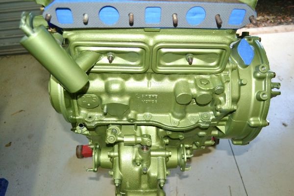

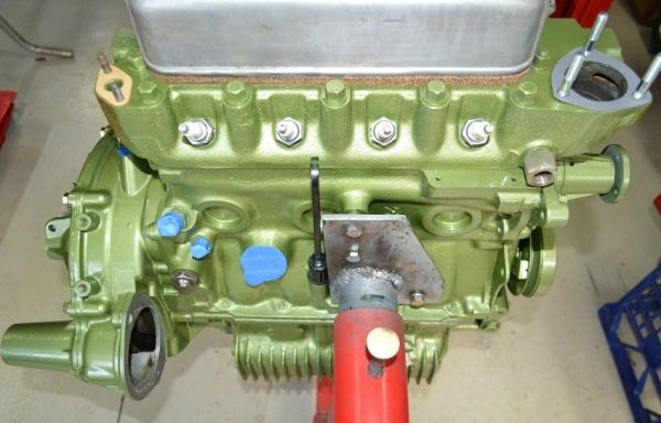

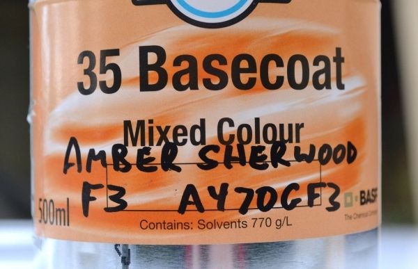

We have just completed a rebuild on a Cooper S original engine and the owner wanted as close to original on the colour. Couldn't get the mix in an enamel so went with a COB (2K Clear over Base). From memory there are 7 tinters in this and while most ones that are close have a lot of silver, this mix has silver with a hint of orange and gold.
After a lot of searching and trials we came up with this:
We used a 'BASLAC' basecoat 35 with a clear on top. AMBER SHERWOOD F3 is a 1970 Dodge colour and most companies should have the same comparable mix.
Dave K.
PostPosted: Sat Jul 19, 2014 4:27 pm
Thanks Dave, I just shrunk the images down a little to a size that fits the screen a little better.
They were massive. I've just pulled them across to the Ausmini Photobucket, so the links aren't the same

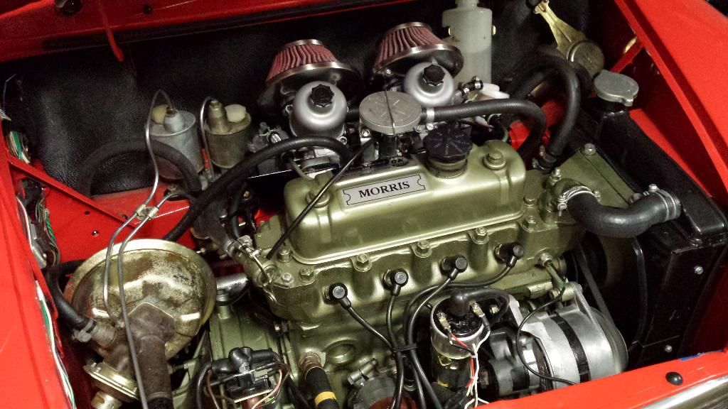

The colour is really bright as it comes out of the gun, but it tones down to a much paler colour as it gets a little heat over the next few months.
Your colour looks much the same as the Mini King tint, so this image of mini today might represent well what I am talking about.
