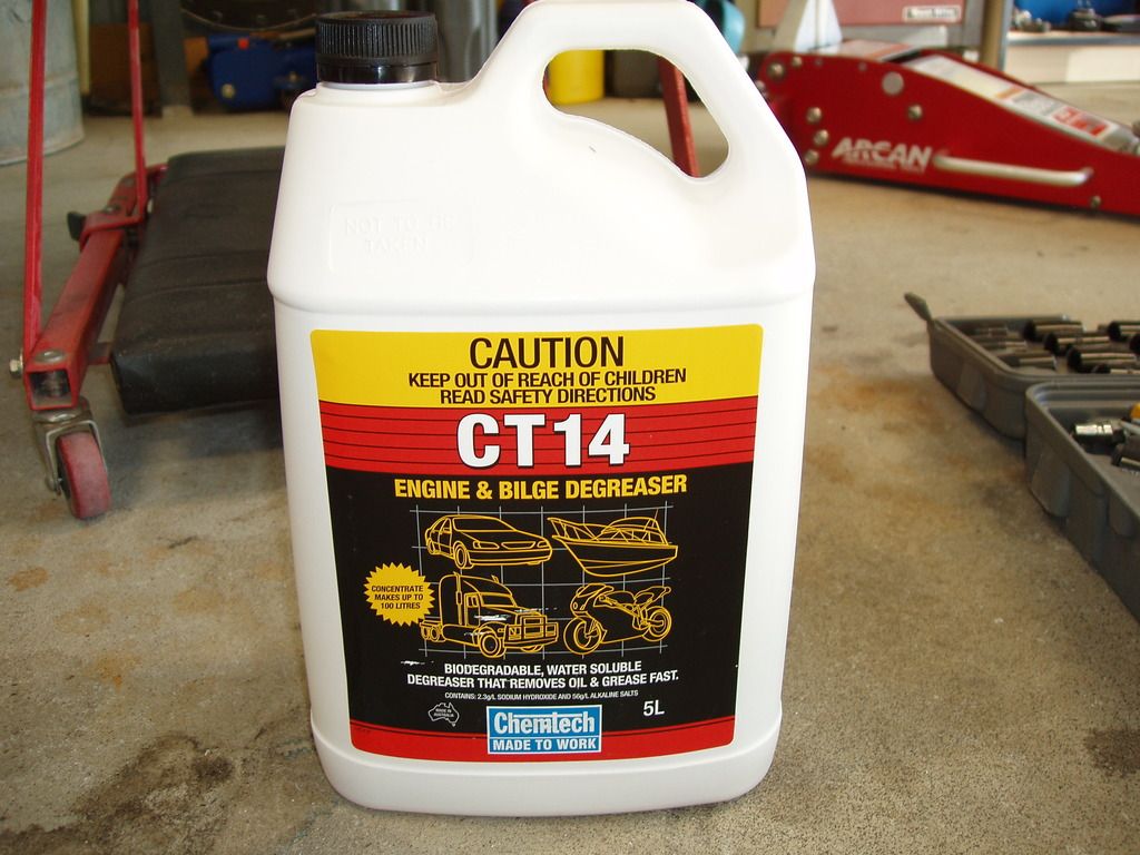

Ended up buying some of this stuff, haven't used it yet so cant comment. The CT brand is meant to be pretty good. Cost about $35 for this 5L concentrate. See how it goes in the parts cleaner.
Looked all over the place for Kerosene from a service station bouser, but everyone who did sell it previously have seemed to stop selling it at least several years ago now! So no luck there.
Buying Kerosene in drums and bottles is way too expensive I think for what the product is. Cant bring myself to do it at this stage :cry:
