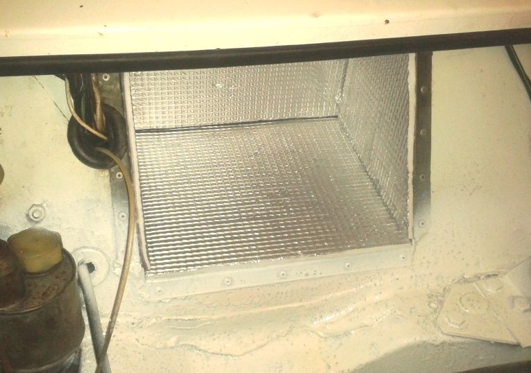

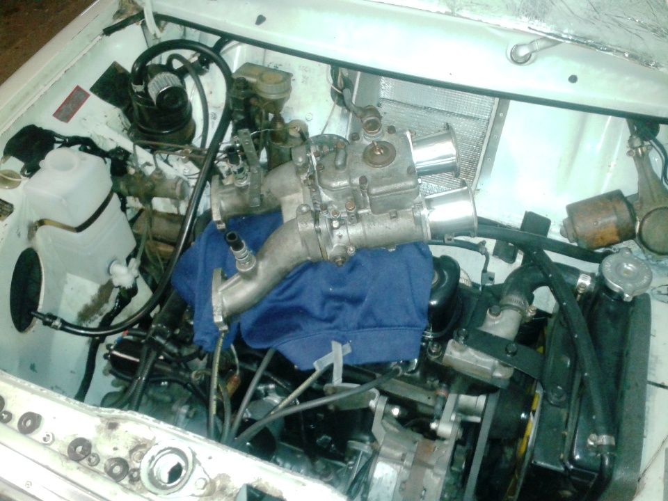

Here are some photos of mine. Homemade job by the PO. There is 40cm from the cylinder head face to the back of the airbox. My airfilter socks hit the back of the airbox.
Had to put some soundproofing in there, couldn't talk to the passengers without it.
And this shows how far it extends inside. (The radio is just glued on)

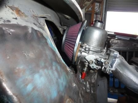

Hi,
I did a small mod for mine. Quite happy with it.
http://s1266.photobucket.com/user/scoop ... f.jpg.html
http://i1266.photobucket.com/albums/jj5 ... 6a6c0a.jpg
Other photos in my build thread if you wanted to look.
Good luck with it, its a great manifold. :D
