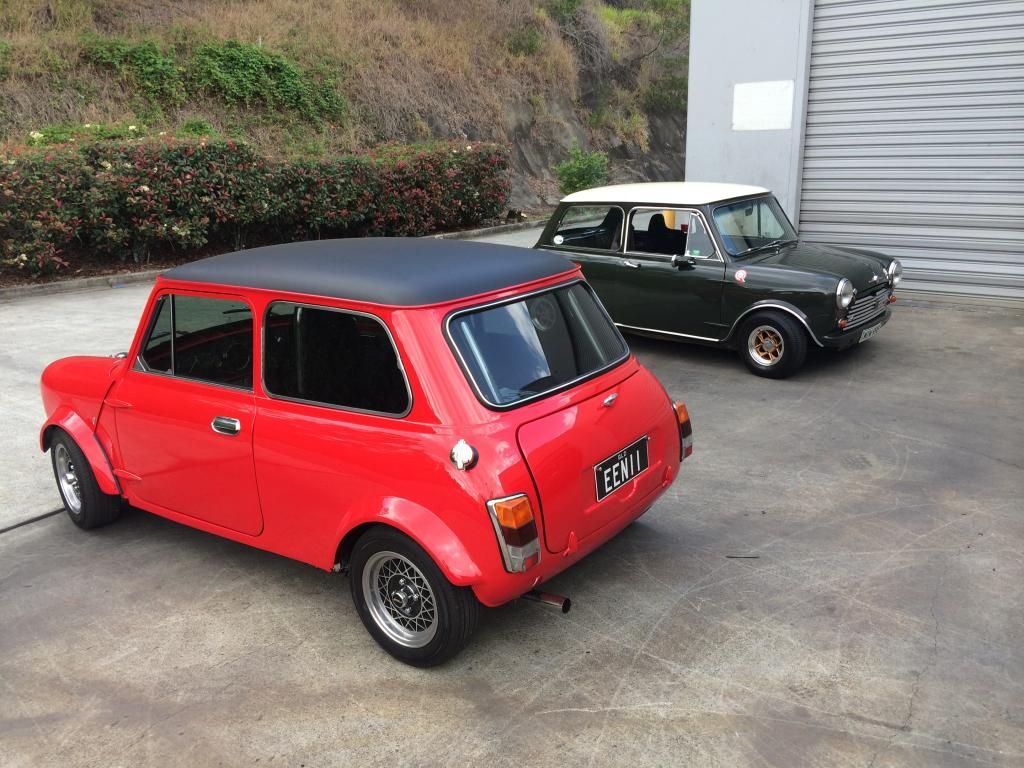

I have the roof wrapped on my mini. We did the body work and 2pack painted it in a booth. I then got a professional to put matt black wrap on the roof. It looks really good but it was very hard to get it into the seams. You can tell its a wrap when you look down into the seams but I am very happy with it.
I agree with miniandrew about chopping and changing colours. At some stage I will take it off and put something else on there. Maybe a printed effect or logo.
Since it is pretty much just a 'thin top coat' any imperfections will show through.
