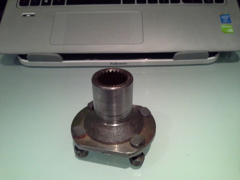

Hi I was wondering if you could modify non hardy spicer gearbox diff covers to fit the Hardie Spicer yokes
I recall that some of the non cooper S covers where a solid casting which may have been from a OZ gearbox and therefore there is enough material to machine out.
Has any one done this.
Out of stock at mini spares and $$$ for what they are
Ta

Just ventured out into the garage.
why cant i simply turn down the shaft of the yoke. its only 3mm larger than a non S one
I can mark it with a file so it should turn down ok
what am i missing here
PostPosted: Thu Jun 23, 2016 7:42 pm
All the torque is transmitted through there, if you turn it down 1/8" on diameter you are weakening it severely.
The splines are bigger than on lesser Minis, that is why the outside diameter is increased.
re the bushes- they wear, usually need replacement on a proper gearbox rebuild. If a sloppy fit, the seals leak sooner.
I would fit new bushes, bugger the expense. :)
Years ago there were Hardy Spicer style drive flanges sold to bolt onto rubber U/J output shafts. Dunno who made them, but I have seen several sets.
the bushes are another out of stock item.
So if i turn out the standard ones will an S seal fit into a non S side cover or do i need a special seal.
PostPosted: Thu Jun 23, 2016 8:43 pm
Both the bush and seal housing bores are enlarged by 0.125" diameter. Look like a S cover when done. :)
S bushes are available, try Karcraft, Minisport Oz or Classic Motoring. I just bought 2.
Edit need to bore bush to size after fitting. They are about 0.007" undersize.
