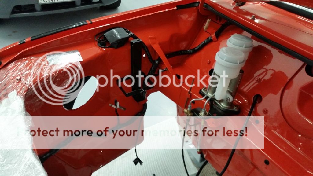

I just fixed up my loom a few weeks ago and installed it its not to hard.
here is some photos if it helps

Thanks for the pictures, this helps with the front! does the loom then enter the cabin through the passenger side pillar and up through the roof?
The rear harness has to go from the junctions on the firewall into the lhs "glovebox" area and into the inside of the A pillar, and up into the roof channel (where the ends of the headlining bows are seated), past the B pillar (where the interior light is located) and rearwards to the C pillar and down to the area where the lhs petrol tank is situated. If you want to do this with the headlining in place it'll drive you to your wit's end, but can be possible using plastic coated flexible cable, or something similar as a leader cable for the harness. If you have the rear quarter cards out that makes the job easier.
Alternatively if you have a friendly auto upholsterer get him to undo as little of the headlining as might be possible along the lhs to enable you to have some access, but noting that to really "get in there" you'll need to have the front and rear screens out. Then get him to fit it all again after you're done.
If you don't have the headlinlng in, then it's a piece of pxxx.
Good luck
