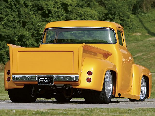

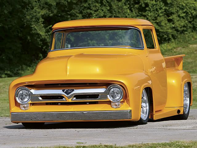

I am overwhelmed by your enthusiasm for the Effie - I take it you are serious?? I have wanted to do a '56 F-truck ever since I was about 14, and only ever a '56 (I would do a '55 if a '56 wasnt available). I think they look so cool! 8)
The cab and front sheetmetal are off the chassis at the moment so its not the most gorgeous thing to look at (except to me :D ) My brother and I are doing it together, in a kind of sibling bonding project that we never got to do when we were younger.
Not a lot is going to be done to it until The Cat is finished. I really want to get that finished and out into the public domain. So allow a good few months (say 6) before any thing is seriously started in anger, except for minor fiddling here and there and gathering of parts (buy up big while the Aussie $ is good).
I have big plans for the Effie, going to try and do all the sheet metal works myself, chassis fab and bodywork too. I want to make it cool old skool but with a modern custom flavour - kind of like vanilla icecream with Caramel topping :wink:
If the mods allow I will start a thread - but that may be against forum policy as it has nought to do with Mini's - except that it might tow the trailer one day!!
Anyway, let me know what you think, I have heaps of pics.
And for those of you wondering what a '56 F100 looks like, here ya go:
Enjoy,
Tricky

I have always wanted to do a f truck... And yes that pic of that 56 looks awesome! I guess I'll have to settle for my much smaller datsun 1200 ute for the time being
Life's a garden.... Dig It!
PostPosted: Fri Oct 23, 2009 8:51 pm
Mmmm,,, yes twin turbo Toyota Lexus/Soarer 4litre alloy V8 with decent auto behind her,,, yes that`s the cream & the caramel :-) smooooth as a babys bottom, cheap & easilly avaliable too :-)
PostPosted: Fri Oct 23, 2009 9:10 pm
Posts: 685
Hell yeah!!! That looks ace.
Nice project, always liked the shape of those too.
Might you be allowed a small space under the 'other makes' section? Or point us to another location for pics.
Good luck with it, it will look brillaint towing El Gato to the races.
Madmorrie
PostPosted: Sat Oct 24, 2009 7:36 am
Other makes would be fine for it I think . Has the yellow one in the photo's had a roof chop or do they look like that originally ? How close is that to yours or what you want to do to yours ? I've got to admit , I have a soft spot for them as well , post plenty of puics when you get the chance (but don't stop on the cat) .

Well, I am amazed at the amount of Mini forumites that get a stump from an old Effie!
To me, a hot looking '56 gives me a mongrel so hard the cat couldnt scratch it!! :shock:
Anyway, since Ian says its fine to start a thread in other makes, so be it. I shall start a new thread directly.
Ian - no, I dont think that one has had a chop job done on it. If it has, its only about an inch or so. And yes, I am hoping mine will turn out something similar to that when its finished. Do you know they still press panels for them in the US!!!!
Gordo - I can get you a '55 F Truck for a very reasonable price, like cheap. PM me if you are interested (or anyone else for that matter)
Matt - I was originally looking at doing a 1UZFE with a Whipple - then my brother bought me to my senses when he said what a travesty that would be. Like putting a small block Chev in it. So then I was entertaining the idea of putting a 4.6 litre 'Cammer' motor in it - same as the SVO Mustang - but at USD$6,500 plus freight, taxes import duty and other charges for a long block only, forget it. So my brother, who know infinitely more about Fords and Chevs than I do, suggested we just use the Y-Block that came with it - so we are. Supercharged of course!
Hallsey - dont mind the tri-5 Chev's either. Saw one not so long ago with a grafted on Caddie front and it looked awesome! That might be next!

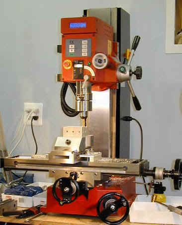

Also, I told you all a while ago I was looking at buying a mill and lathe so I could do some machining and turning and keep all that stuff in house and save dollars and time. Well here they are. Not quite what I was aiming for the first time around.
I was originally going to buy one of these:
But came home with one of these:
And the lathe, well was looking at this:
But ended up with this (slightly larger machine with more options):
Time to make some serious stuff.
Tricky

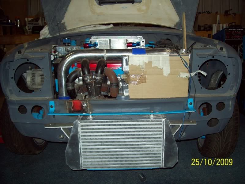

I promised some progress shots and here goes. Trial fitted all the alloy pipework for the FMIC etc today, just to see how everything would go together after it was fully welded, and to see how good we really were. Other than a slight bit of interference with the oil cooler bracket touching the charge pipe to inlet manifold, it all went together rather well.
You have seen these shots before, but now without the masking tape holding them together. We need to make one or two brackets to hold the pipes on, and then fully polish them, but other than that, they are complete.

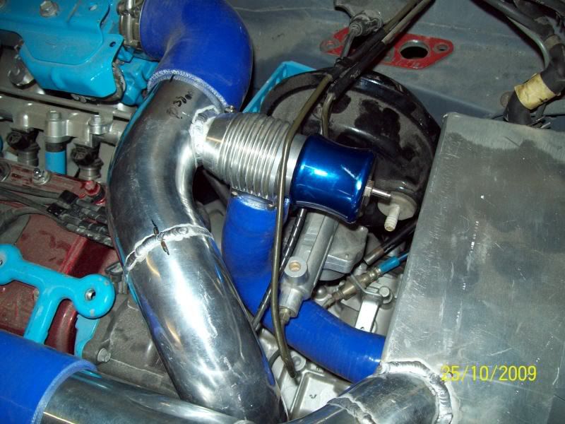

Turbosmart BOV fitted and plumbed back into airbox:

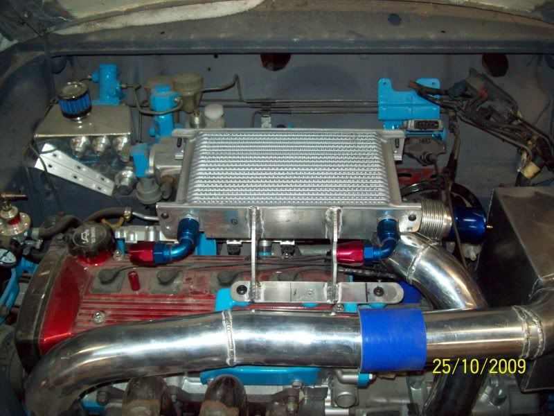

Oil cooler fitted:

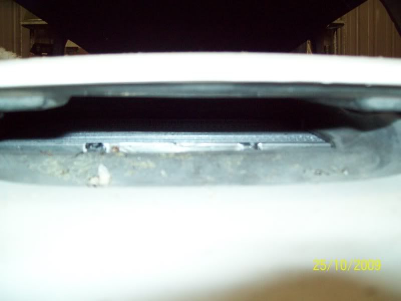

Oil cooler fits perfectly to the bonnet scoop seal:

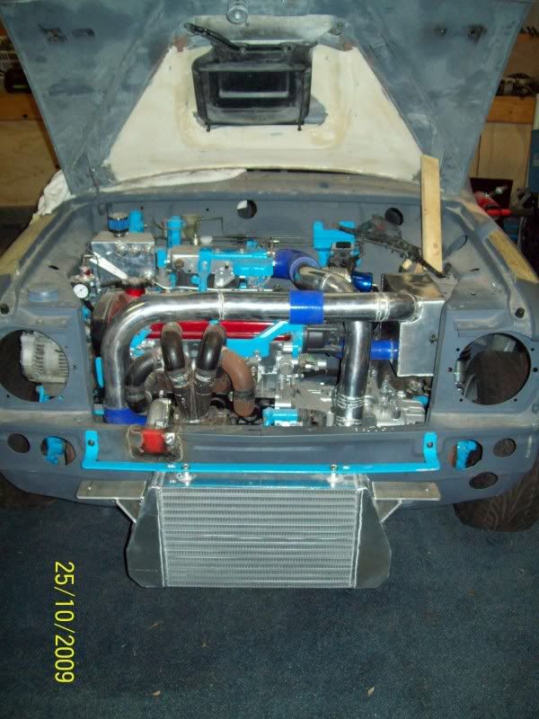

Radiator installed:
As you can see, not a lot of room left, plumbing with big pipes, in this case 2.5" alloy piping, takes up a lot of room. Only thing left to do in the engine bay is the gear shifter linkage and water lines for the engine and heater, and then it will be time to disassemble for painting. A big thanks to Cameron (Cazmo) for doing all the alloy welding, great job Cam!
