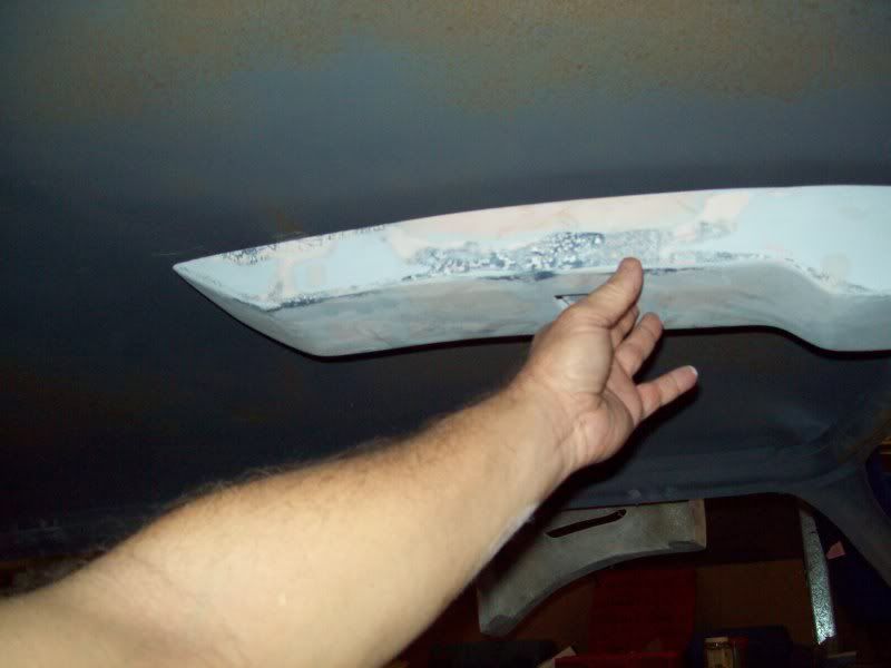

I wanted to do something a little different from the everyday Mini (why is this such a curse?) and I wanted to have some controls in an overhead console. Ever since I saw my brothers RX4 I thought overhead consoles were the dukz nutz. Anyway, prior to bogging and sanding the roof and getting all that fair, I welded in a bracket so that this would happen.
While I was off work I decided to try and fabricate an overhead console out of fibreglass from a mould. And this is the result. It will house the interior light (details of which are yet to be released but will look great I think), a couple of idiot lights (door open, low fuel and seat belt warning lights) in the same vein as the interior light. In the centre is a cutout for the digital keypad which is actually the coded ignition switch for the starting circuit for the engine (ala Transporter 1 and 2). I think it turned out great and will be painted the same colour as the rest of the interior bits.
Bogged, sanded and ready for final hi-build and sanding:
View from front:
In position:

are you going to have the roof lining?
will you make a rod that runs flush around the top unit than runs through the hem of the lining
or cut a rectangle and velcro or clip it to the unit
1969 Blue Mini K, 1330cc, Weber 45, polished aluminum roll cage, Race seats, 4 point harness, full rewire incorporating 8 fuses, 6 relays and new headlights :) just needs tyres front shocks and a windscreen til re-register
PostPosted: Mon Aug 22, 2011 9:53 am
Hey Richard,
Yes, the hood lining will still be installed. If you have a look at the pics, you will notice the roof console hangs down from the roof perhaps 25-30mm which is enough for it to touch the hood lining but clear it.
The hood lining goes in untouched, the the unit sits underneath - might not be too noticeable in the photos. There is a bracket welded in at the rear, which will protrude through the hood lining to allow the unit to clip/screw to it. I used the original hood lining as a depth guide, so hopefully I am failrly close. Plus or minus 10mm is neither here nor there. I will adjust the bracket in the console accordingly to get the depth spot-on once the hood lining has gone in.
The unit clips up at the front with a bracket that is screwed to the roof sill where the old rear-view mirror would be. The new rear-view mirror is glued to the window ala Ford.
Hope this explains.
