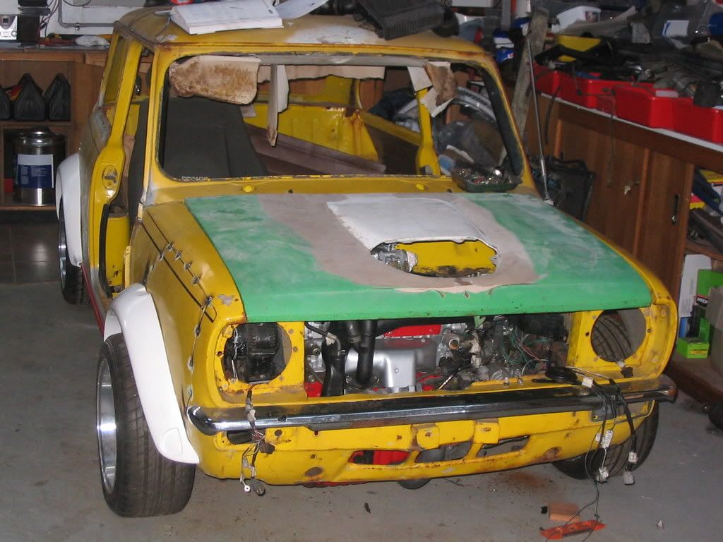

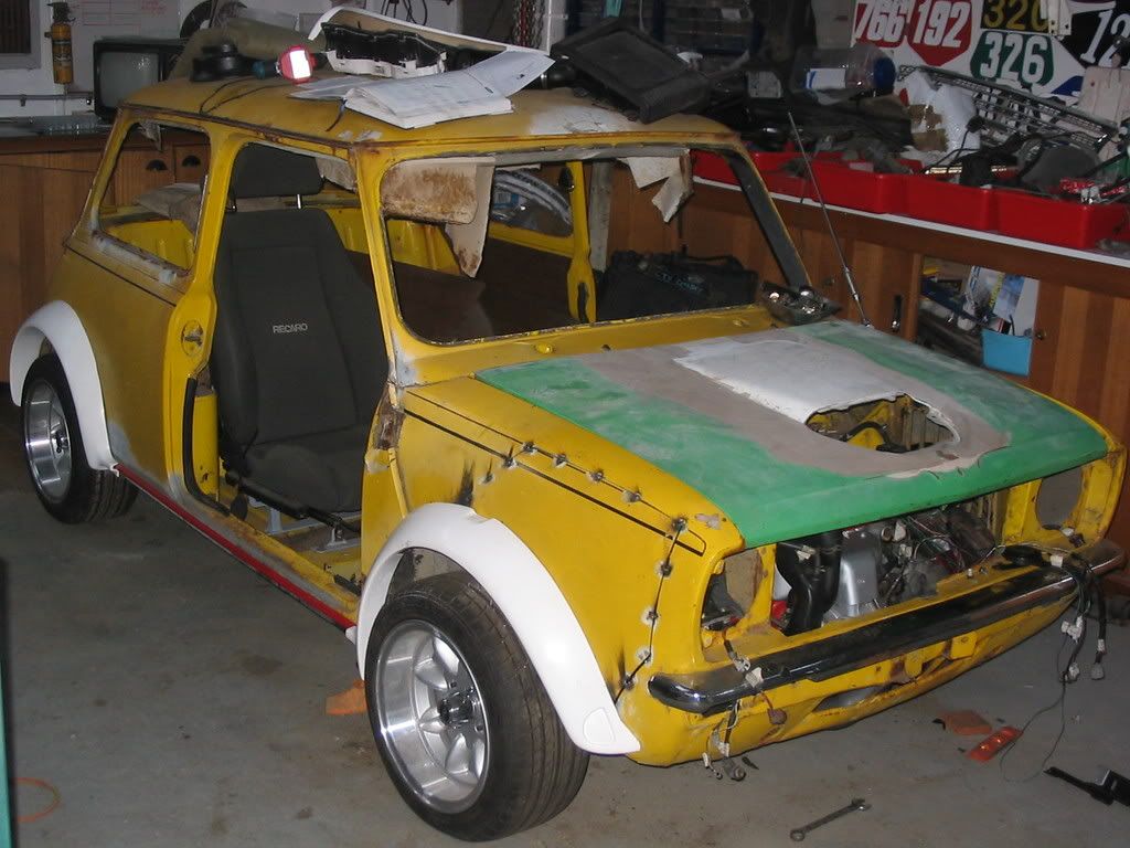

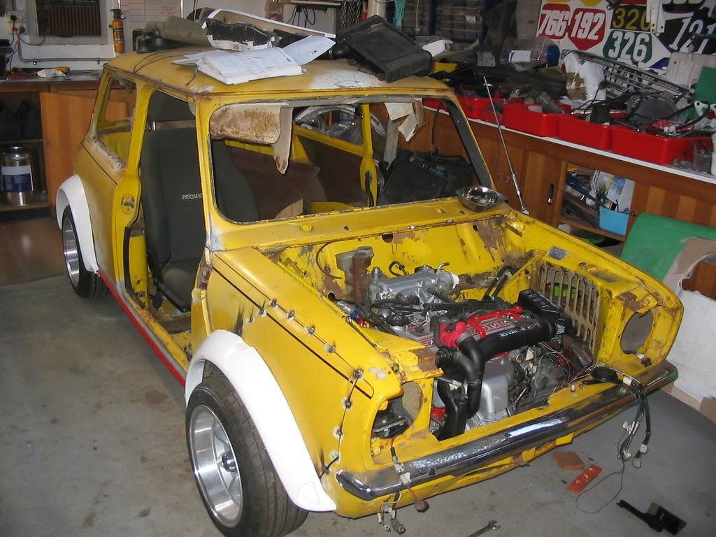

Test fitted the sports pack arches on the dunger shell today. I have'nt
got the rear spacer drums on so the rear wheels are in a bit
Cheers Hallsey

Looking good there Hallsey, wont be long now Ol' Son!!

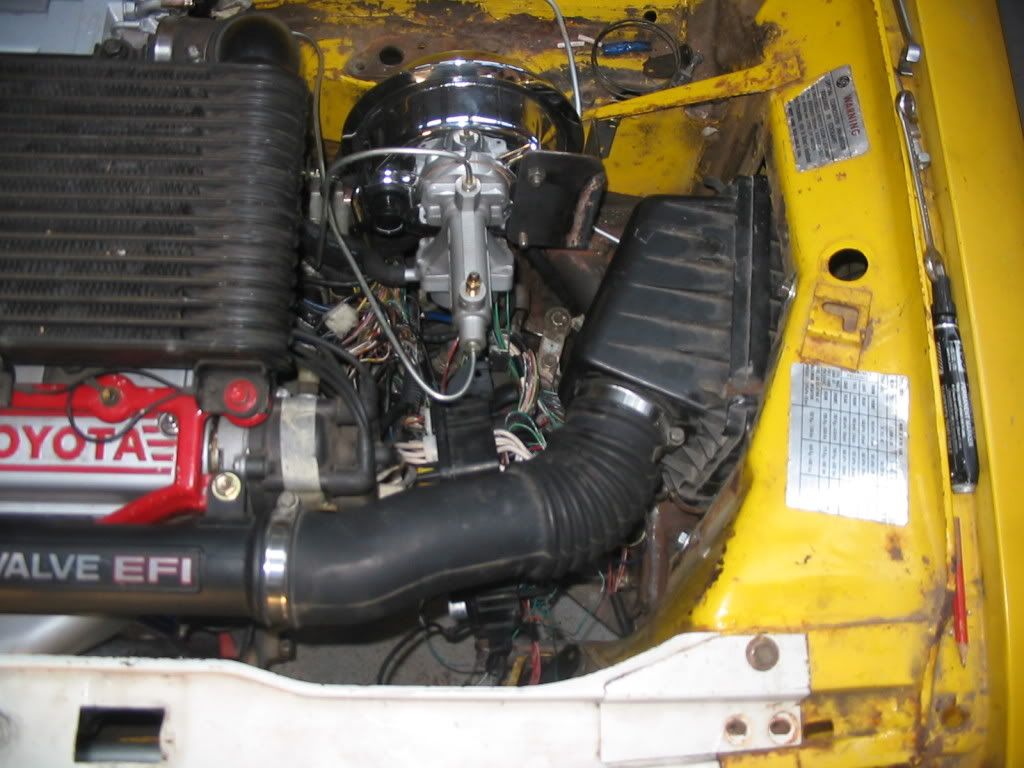

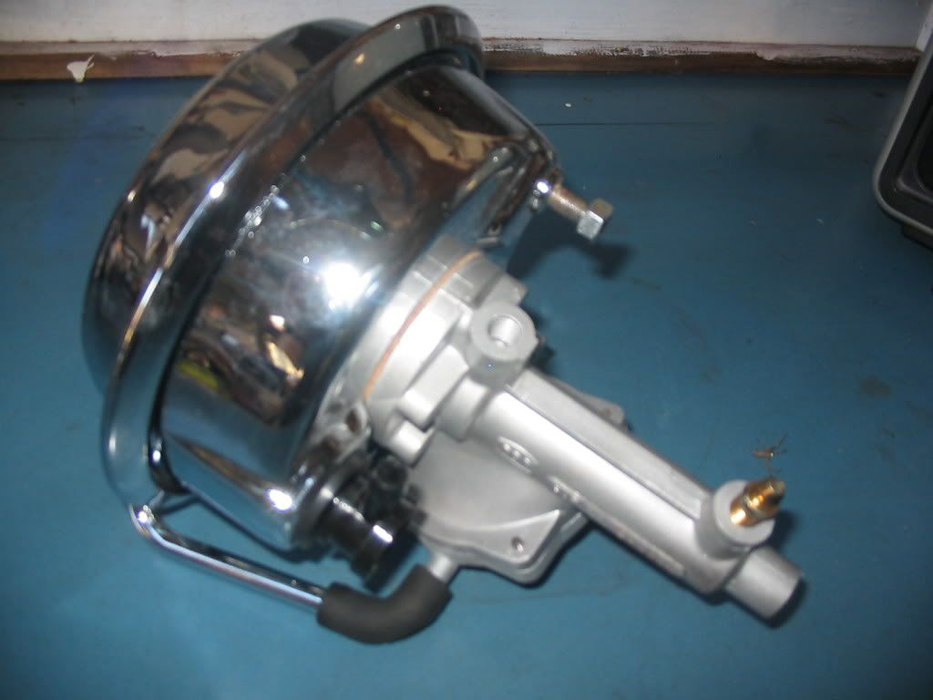

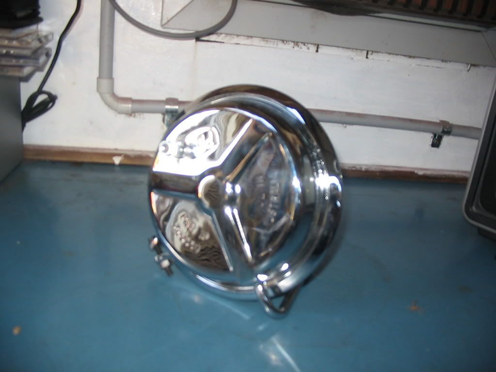

Time for a bit of an update, progress has been slow but steady, I got my
power booster and air box sorted so here's a few pics

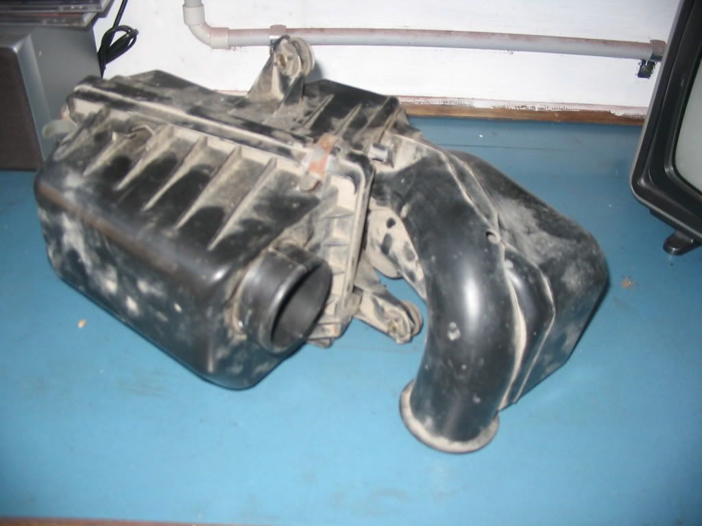

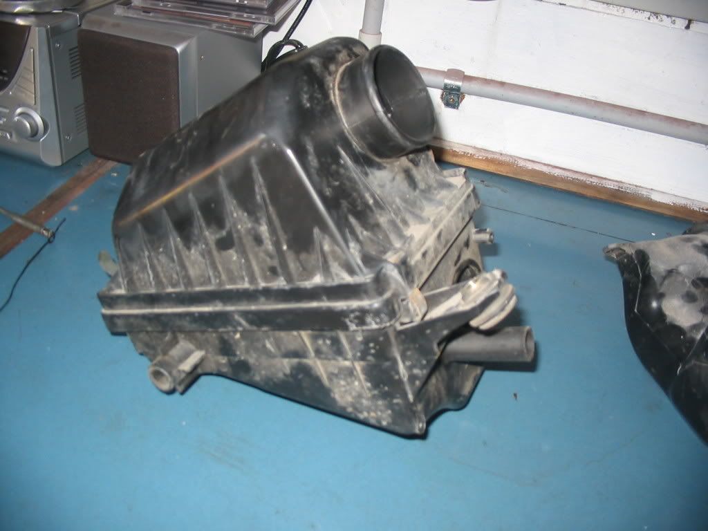

Air box is from a fiestiva

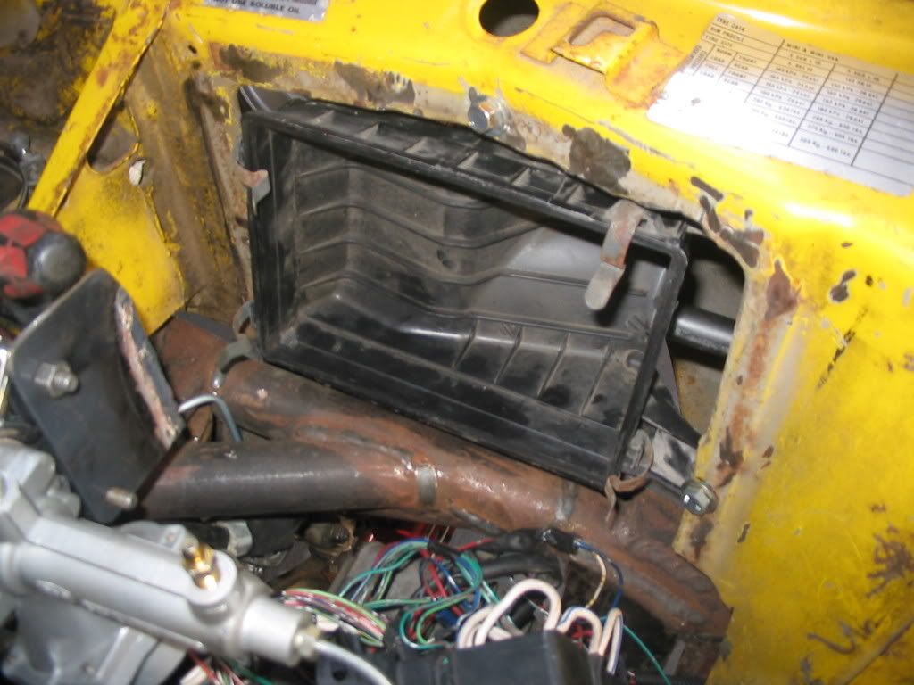

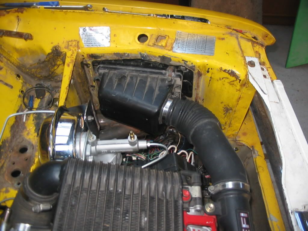

I cut out the old radiator area for the air box, its a fairly good fit, I'll tidy
this up when i put it in the good shell

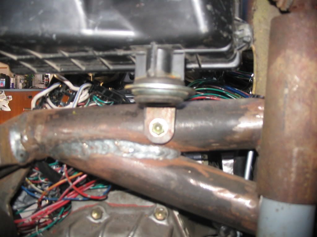

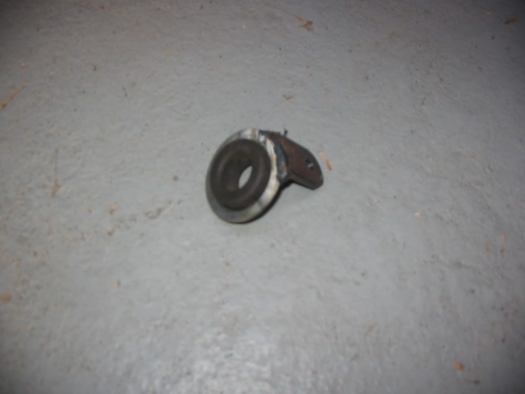

Put a nutsert in the frame for a stabilizing bracket
Then made a little rubber mounted bracket
Fitted up its nice and solid
The cars away getting the radiator made , hope to get it back tomorrow
cheers Hallsey

That's a very neat way to fit your airbox, well done.

That works Hallsey, well done Ol' Sock!

nice work with the air box mate looks like in belongs there. keep up the good work.
