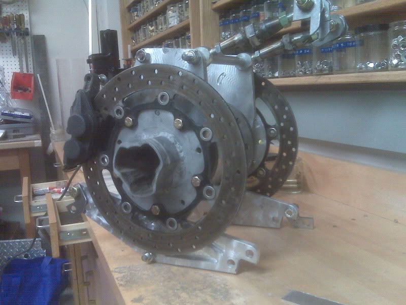

I'm currently doodling with inboard brake set ups. Thinking I could hang a rotor either side of the chain sprocket. Though using a mini hub there is no real weight saving as you need the brake assembly to locate the wheel.
Also, i've been trying to find as many internal pics of the gtir diff as possible. It actually looks like there is one half of the bearing carrier that bolts the assembly into the diff casing.

Staring at pictures of diffs all night must had done things to a logical thought process. I'm thinking (as a proof of concept) that I "could" use the existing diff casing as the new cradle.
So here is a picture of the standard gti-r diff.
and i'm thinking off hacking of the bits shown in red. Then it would be a matter of making a "cup" for the diff as previously discussed.
The rear casing of the diff could be used as the mount (as it is from the factory)
