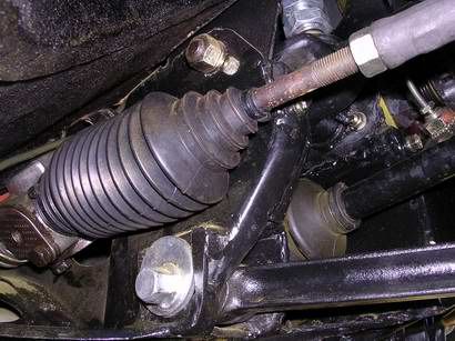

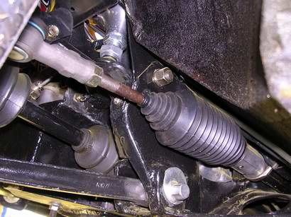

If you are modifying the sub frame (of course) I reckon the best option is to copy the excellent work of Con Torisi on GTI_mini's car (the yellow one in Perth). That car used the modern lower arm adjustment method of an eccentric pin. It is easy to cut the adjusters from a car at the wreckers and adapt it to the location where the lower arm mounts in the sub frame. Con's set-up used standard lower arms but had heaps of adjustment for frame inaccuracies and selection of optimum camber. I have photos I can send if my explanation is too crap.

Here are photos of Con's design front lower arm adjuster. Simple and effective. These eccentric bolts are in just about every modern car. Most have another disc piece attached to the main circular part. This is saw tooth and there is a small locking bit that engages the saw teeth to stop the whole lot moving if the main bolt comes loose.
I remember them being on the back end of my mates 1985 Corrolla, so they would be cheap at the wreckers. Leaves more $$$ for the Ohlins, Penskes etc...
M
Many more pics available. I spent about an hour going over the car one Mini Muster. :wink:
yeah this is kinda what i had in mind for mine...alot like the vtec frame made by the gomini bunch:
or atleast it looks that way to me :)
