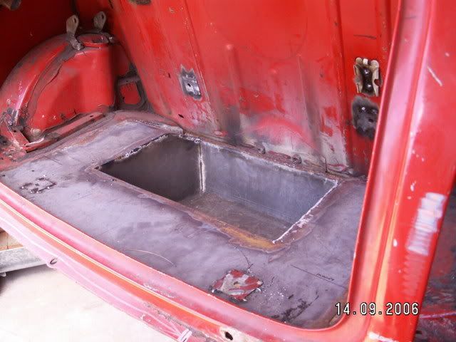

This is a fuel cell I had made up for El Gato:
Contoured to fit the mini shape, and using a std Aussie Starlet fuel pickup and sender:
The boot space was modified first, and the fuel cell designed to fit the space. The boot floor and battery box were suffering from a bad case of tin-worm anyway, so out with the grinder:
And this is how it sits:
Volume is 45 litres which is more than enough. Also, the centre of gravity is kept way down, about 400mm below the std mini tank, and inline with the centre of the rear subframe.

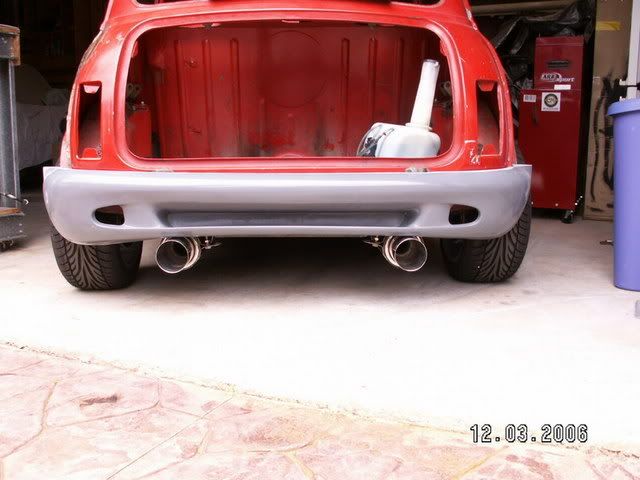

PostPosted: Thu Sep 14, 2006 5:25 pm
Mini K,
I have split the exhaust just in front of the subframe so it is a twin 2 1/2 inch system out the back.
This pic will show it best.
All you need is just some forward planning. :wink:
Regards,
Tricky
