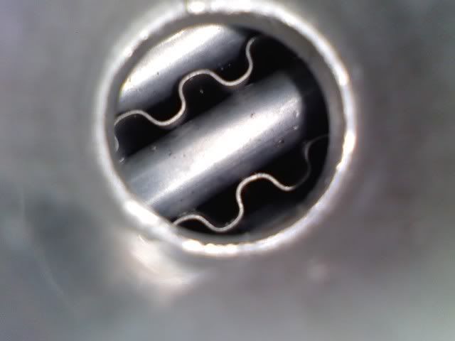

I thought i'd post up a pic of the PWR core, you can see from the pics that there is not a lot of surface area and it's quite restrictive. PWR actually use their air-air core in their cooler, whereas Plazmaman have developed a proper water-air core for this application. They will even back their product and will guarantee that their cooler will perform better than any other W2A setup on the market or your money back!

It looks a simpler design too Josh, as in easier to manufacture.
So, if that be so, how does the cost compare to the PWR unit?

It looks simpler, but it is CNC machined and the core is a piece of art. They are slightly more expensive for the PWR of the same [b]size[/b ]and are of a MUCH higher quality, but they handle more power - so work out cheaper for the size you would need to go in the PWR to equal the cooling.
I had a 4x6 PWR Barrell (Rated at 270HP - didn't even get to that did i) and the one i have now is the equivalent but only slightly bigger. To get a PWR one to cool as efficiently you would need to get one much much bigger which apart from not having the space to do so also costs more than the smaller Plazmaman W2A (rated at 500HP)
