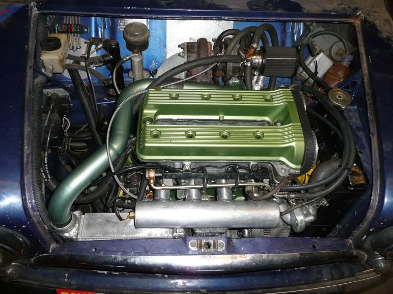

God damn that bastard is tall.

It may well be a bastard but "Tall"???---> it`s no taller than a std mini oil filler cap :-)

Is it really?
God damn that bastard looks tall.

i thought the same. i think because it's just much wider at the top, makes it look taller

Jan it`s a "bleed" pipe,,, the water gallery behind there is actually higher than the top hose outlet hole so i drill it out above there to bleed out any air bubbles that would get caught
the 16v isn`t as bad in that dept, so i normally only do it to the 8vs
remember that these donks originally lay down so not a problem for the bike owners... But when we fit them to mini donks & stand them upright,,,well,,, i`d rather not have any "steam" caught inside the head
Good idea! had some thoughts on this with a bleed valve - but hey - keep it simple ;)
