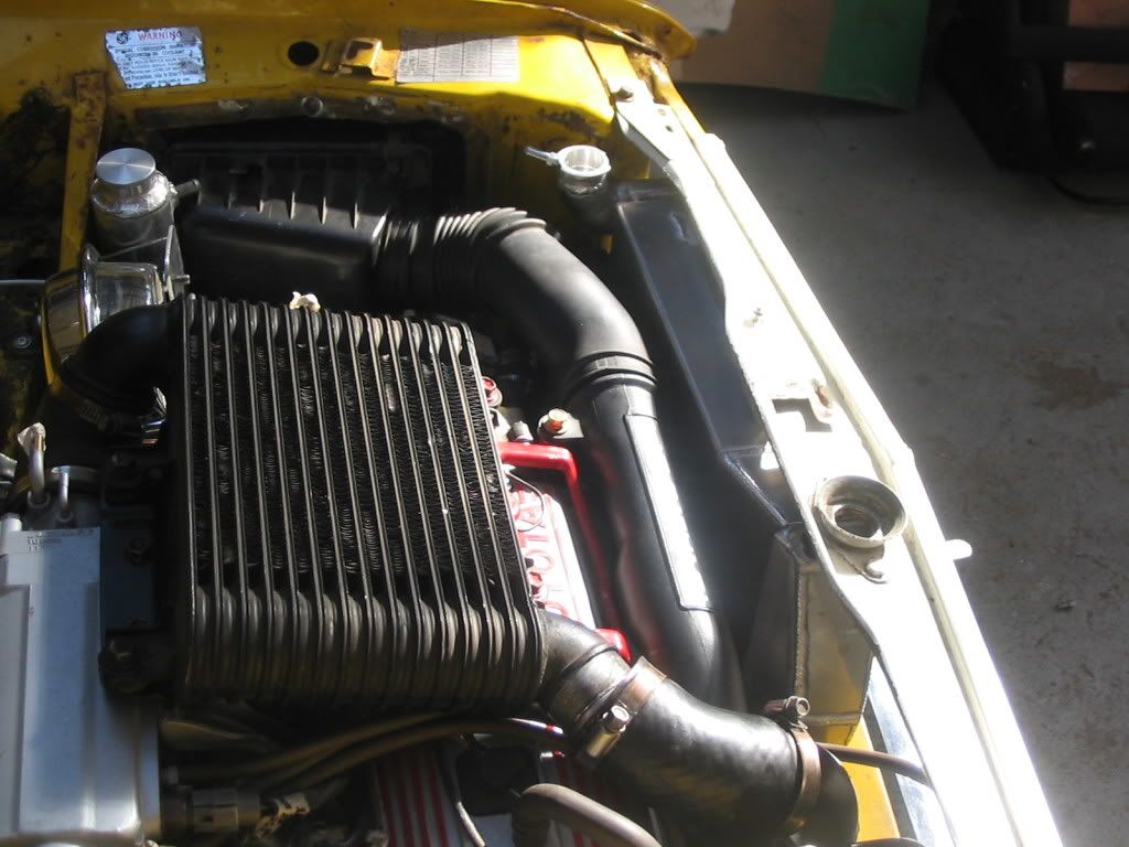

Is the airbox readily ideantiafiable as a festiva one? like does it have FORD printed on it anywhere? cant tell from the pics. Reason I ask is my engineer wanted me to run the factory airbox. He did however mention that he was not familiar with the factory airbox from an EP82 looked like. SO if it isn't obviously not Toyota nobody is likely to argue. Yours is going to look 'factory' enough I'd say.
Madmorrie
PostPosted: Sat Apr 11, 2009 1:13 pm
Posts: 404
G,day MM
No ford markings at all , frank said the same to me,but he strongly hinted (wink wink) that if it looked factory he would'nt know the difference

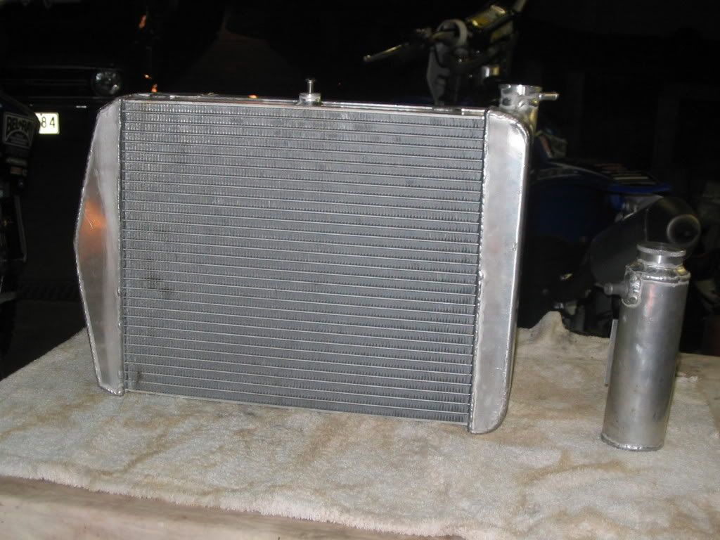

A quick update, got my rad done ,it's a fairly tight fit but should work a
treat.

that's going to look mean on the road, will you paint the radiator black or leave as is?

Hey Hallsey,
Nice radiator. Is there some formula you used to come up with the capacity? Or was it just as big as will fit? Can you tell me the dimensions? Was it exxy?
It looks like there is no ridge on the inlet and outlets. You might want to double clamp the hoses so they don't blow off.

G,day clutch monkey, na leave the bling i reckon.
MM only roughly went on capacity,bout the same size as a commodore
, a bit excey, $950 for core, tanks, fittings, cowl,fan and catch tank,
should work a treat.

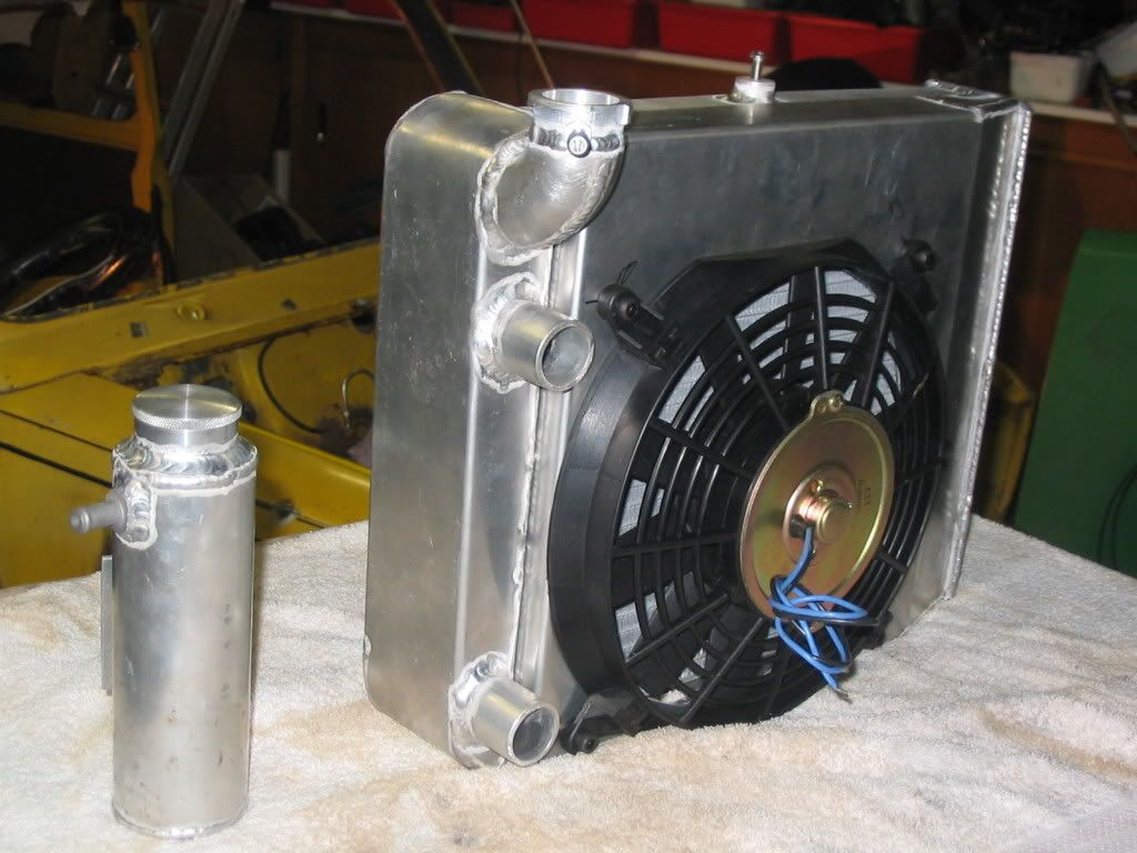

might be a silly question but why is the rear part of the rad covered except for the thermo fan part.. surely the air passing through will get stopped causing heat to build?
Potato
PostPosted: Wed Apr 29, 2009 10:52 am
Posts: 953
Location: NOR, Perth, W.A.
The blank is there so when the fan turns on, it draws air directly through the radiator rather than sucking from the edges of the fan at the rear of the radiator (air will always travel in the path of least resistance - which is not through the radiator). Normally, air flow would be reasonably sufficient through the radiator and fan (when the fan is not on) and Hallsey would have a thermoswitch which turns on the fan when the coolant gets to a certain temperature. Look at any OEM radiator setup and you will see that the fan will have a (plastic) shroud around it.

Well answered Mearcat ol son
