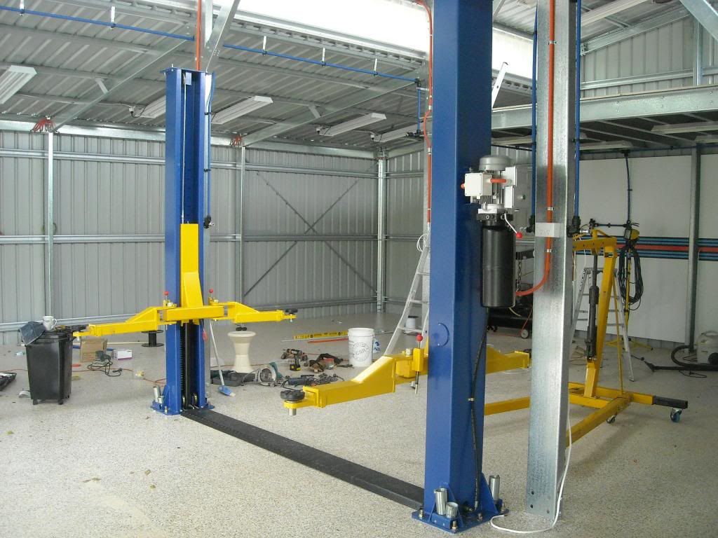

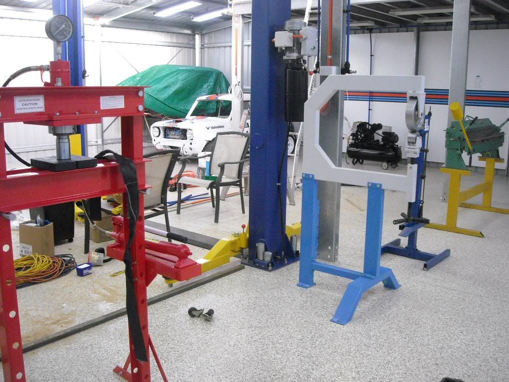

The hoist in in, bolted down and wired up. Man, what a job!! There are ten x 18mm dynabolts that hold both posts down. But, in fact, they arent 18mm,but larger. The installation instructions calls for drilling 10 x 18mm holes into the concrete for the anchors, but at first the anchors seemed way too large for the holes. I ended up getting a lump hammer and driving the bastards in, like thumping the unholy sh!t out of them. During the first one, whereby I had pounded on it for perhaps 10 strokes, and it had only gone in about 40mm, I was thinking to myself "If this all goes pear-shaped, there is no way I am going to get this dynabolt out. No Way!!" But in fact, that's how you install them apparently, you just drive the things in unmercifully. Needless to say, I was absolutely knackered after I had them in.
One post needed a slight packer underneath but that was about it, the floor was more or less level. Then, I ran a bead of silicone around the perimeter of the base plates to keep the dust, oil and crap from getting underneath and staining the floor. I ended up supplying my own junction box to do the electrical connection in - the hoist just comes with a fly-lead and thats all. You could put a plug top on if you wanted to, but I have mine hard wired. The junction box has another use too, in that there is an unterminated e-stop wired into the circuit. I ended up ordering one off flea-bay and I will install this into the front of the junction box when it arrives.

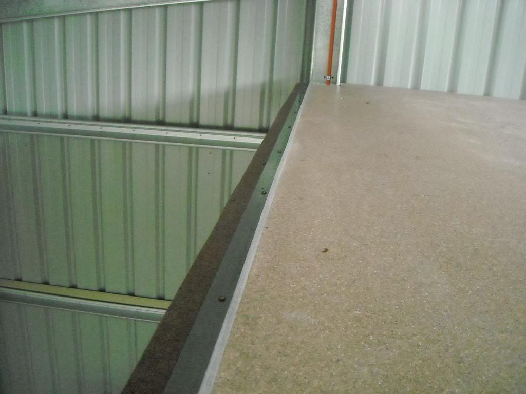

The mezzanine floor is in, screwed down and virtually finished. At the front lip I willl end up folding up a bit of aluminium treadplate and put it along th edge to give it a bit of ding resistance. There may be some big, heavy items going up there so that edge could get a hard life. 12.5m2 of storage space - woot!!!
I have installed a toe-rail along the sides of the mezzanine, and I will end up putting up some side walls along both sides to effectively 'box' the mezzanine in. That will save any chance of anything falling off the mezzanine into the machinery room or onto the roof of the spray booth:

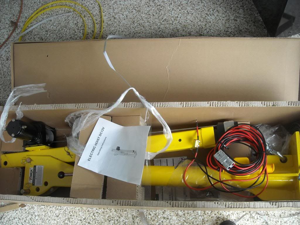

And this arrived mid-week - its my electric hoist for getting things up and down from the mezzanine. Its fitted with a 12VDC winch, and is capable of lifting 600kg (double-line pull)!! :shock: Not that there will be anything this heavy going up there, but the VTEC engine will live up there for a while and I'll be buggered if I will be putting that on my shoulder and climbing up the ladder with it. The boom folds, telescopes and it swivels 360 degrees. I will need to have a 12vdc battery up there and power to plug in a permanent battery conditioner but It will make life so much easier. I could even use it to pull cars up the driveway!! I will go and get a large steel base-plate cut to spread the load across several joists and the front bearer.

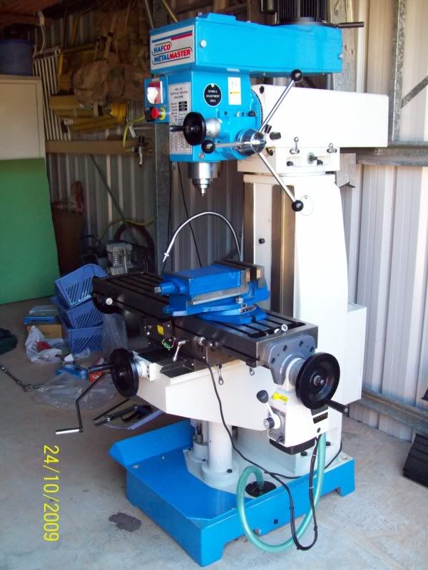

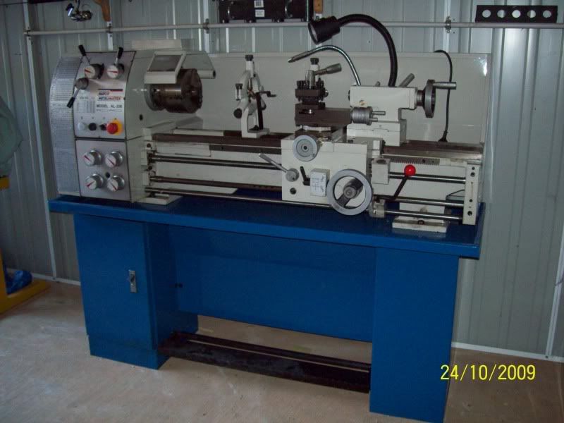

Nick, thanks for the kind words mate. I have had both the Mill and Lathe for about 3 years now, here are some pics of when they arrived....

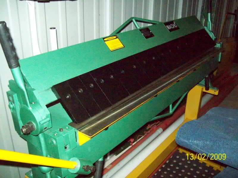

Ross - panbrake I got just before the other two machines above. Dont have a guillotine as I usually use shears to cut my sheets...
In reality, there is not much I need to get, I just need to have it in one place and easy to get to and use, which at the moment, it is not!!

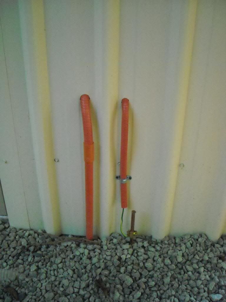

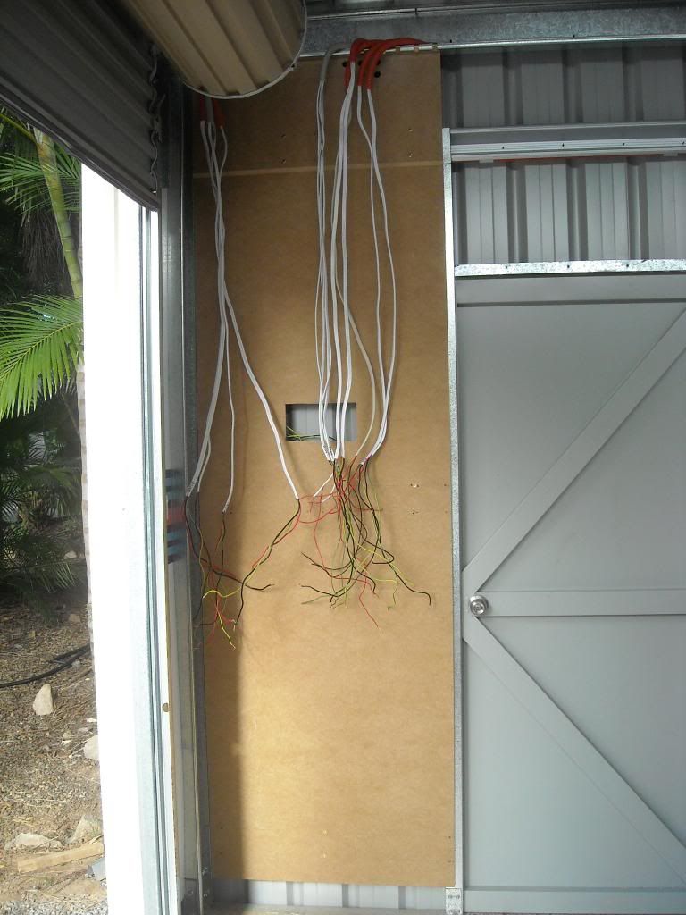

So milestones - the power finally went on Wednesday, and the wife was instrumental in helping me pull cabls through etc. No more leads!! But, I then decided that I didnt like the sheet metal panelling (old roller door sheet) that I had used to mount the sub-board (in reality, I did it prematurely so that Chris the floor guy could do his stuff). So, I decided that it had to match the rest of the shed. So, disconnected the board, pulled out all the cables, bought some more MDF sheet and cut it to size and fitted it up:
Then, fitted it off again, and voila, lights and power:
The cable entry points will end up having a cover over them from 2.5mm alloy treadplate just for a bit of mechanical protection:

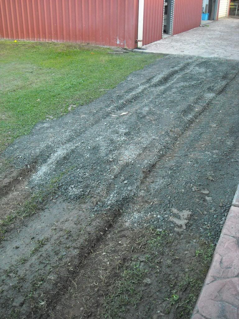

Friday the forklift showed up. Now I could move the machines from the top shed, down into the bottom shed. But, it turned out to be a comedy of errors. The forklift continually got bogged up behind the house. So, hook up the trailer, went up to the local landscape suppliers, and got a metre of roadbase. Then spent the next two hours shovelling the suff and levelling it out (broke the handle on the rake) to make a platform. The forklift still dug in so I put down all the spare sheet metal from the shed (roller door portector). This folded up like a tin can under the weight. Scrap MDF from the shed panelling worked as long as I kept the speed up. After every run I compacted it down with the X-Trail - it took all day!!
But finally, by days end, the machines were in their new home:
At the end of the day though, with no load on it, went to turn it around behind the house and ran off the end of the concrete near the washing line - irrevocably bogged to the floorboards. I just left it there overnight and tackled it the next day. The X-Trail did not budge it, so had to get the neighbours front-end loader/tractor (lucky we live on acreage!) over to help lift it out. The ground was just water-logged clay, so no wonder - clean up in aisle 6!!

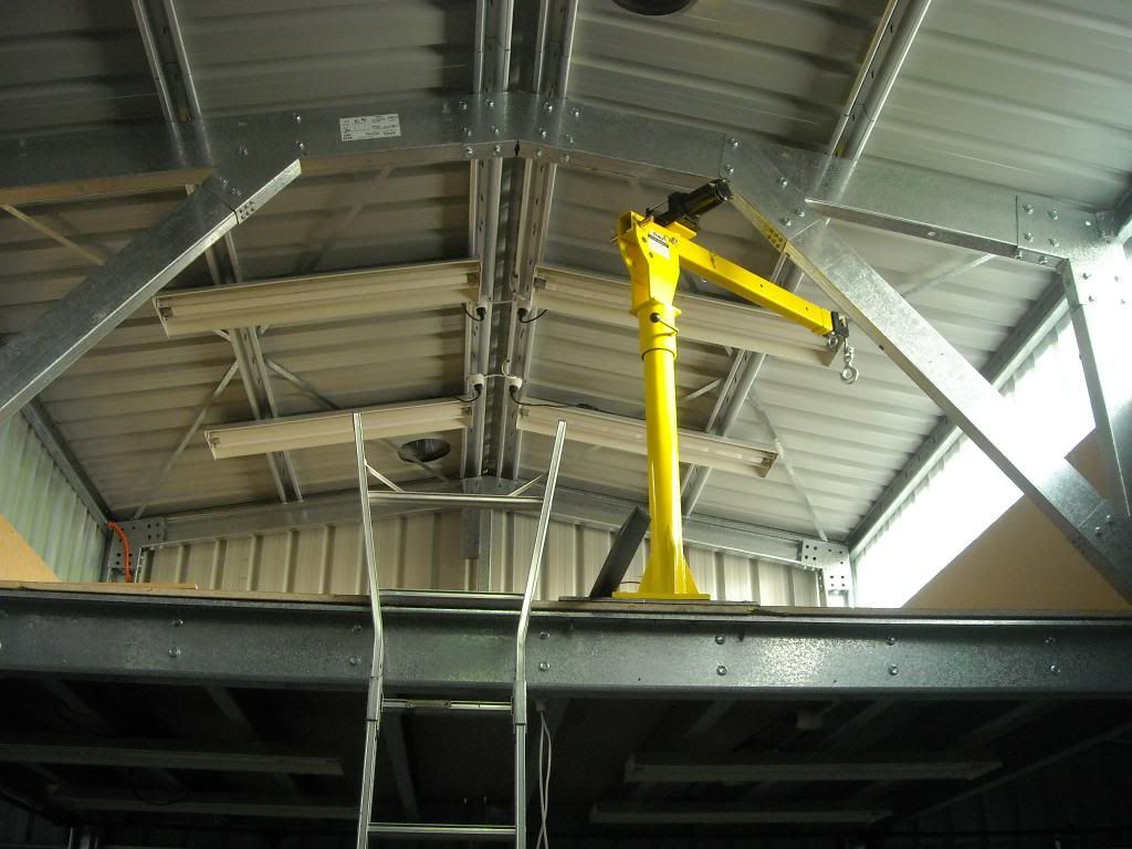

Installed the crane up on the mezzanine. Thanks to Cam for providing the base-plate for the crane. There are 10x 16mm bolts holding the base-plate and crane to the mezzanine joists. Once it was up and installed, I swung on it, not a creak or groan, solid!! Just need a battery up there now and power for the battery conditioner. Even though the photo doesnt show it, it is in the pefect location and can articulate up and down and rotate through 360 deg. without hitting anything:

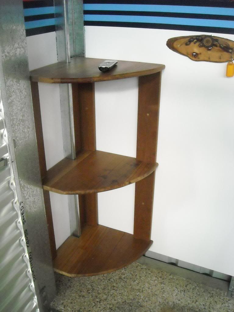

I knocked up and installed a little bit of joinery for somewhere to put the cordless phone, coffee/tea for clients and my mobile phone etc. Key hanger-up thingy for clients and shed keys:

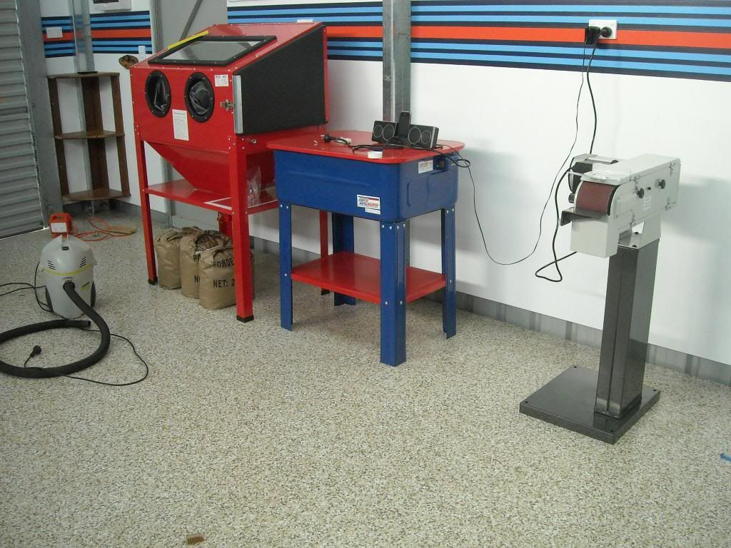

Moved all the rest of the gear into place - finally have enough room to use the english wheel and to use my stuff without interference:

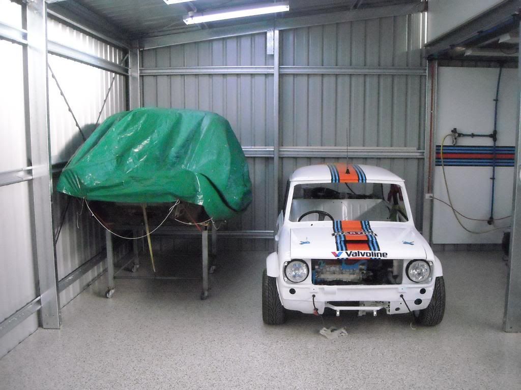

And finally, at the end of the day, moved in some tenants (of the non-permanent kind I hope!). Leonidas is still under the covers but El Gato is taking pride of place, and loving his new, airy, light and spacious home. Thanks once again to my lovely wife for helping me push him up the driveway and into his new home.
