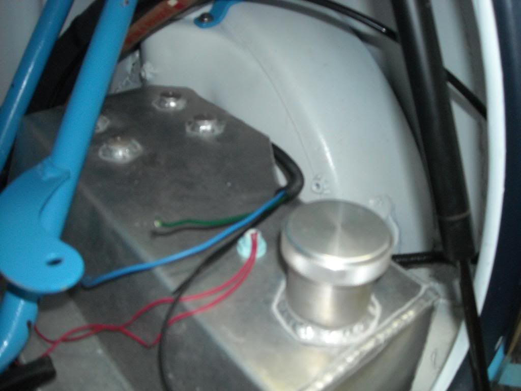

I realised I needed a few more Earls fittings for the swirl tank and I will order those this week so I can continue this weekend and hopefully get the boot closed out - I think I said that last weekend!!! :shock: The overflow pipe from the swirl tank to the fuel tank is a -4 hose (5.56mm ID), whereas the Earls fitting that I have on the top of the swirl is a -6 fitting (8.9mm ID) - so the hoses/fittings are incompatible. I bought them probably 12-18 months ago now so I must have gotten mixed up or forgotten the correct size. :roll:

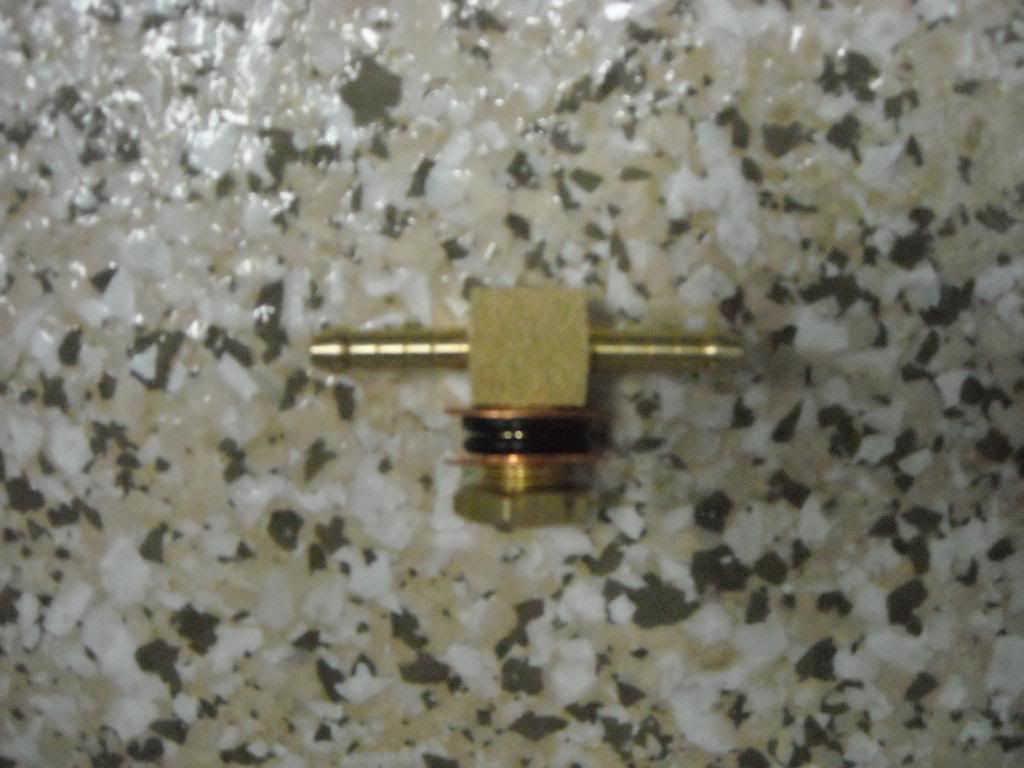

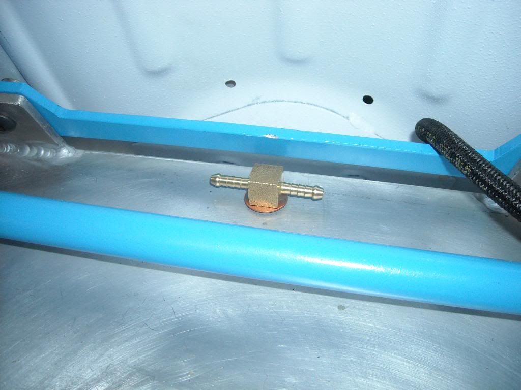

Anway, I got the fuel tank vent pipes all done, it was simply a case of a quick trip to Masters to get a 1/4" fuel bard 'T' with 1/4" BSP thread on the tail end. I grabbed a few copper washers while I was there so I could sandwich some o-rings between the fuel tank and washers to allow for an airtight seal. Installation was simply drilling a 12mm hole with the step-drill and then screwing it in - had to take out the fuel sender/strainer/pump unit to get my hand in there to tighten the nut though, but all good in the end. Then it was a case of trimming the hoses to length tightening them onto the barbs.
This is the brass Tee - 1/4" bards and 1/4" BSP screw thread - note the sandwiched O-rings between the copper washers:
Installed in the tank:
And with the hoses cut to length and connected:

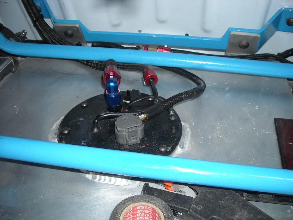

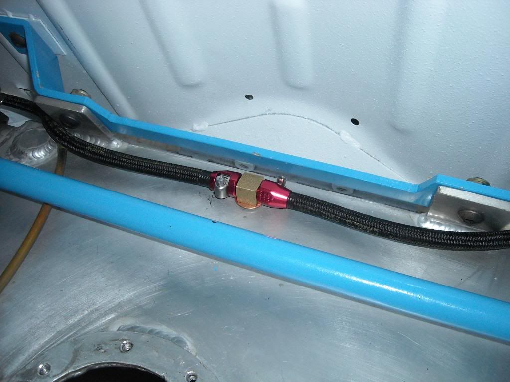

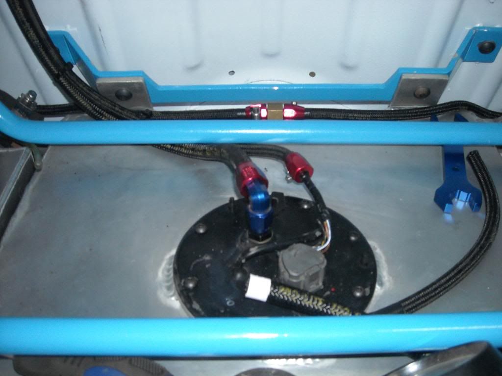

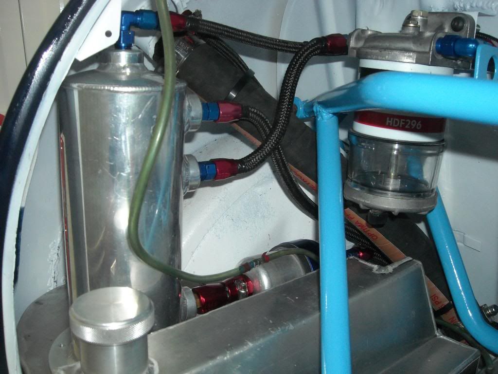

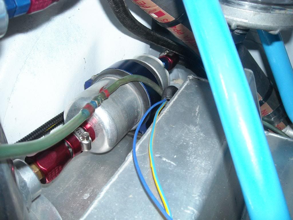

Last weekend I did manage to run all the fuel lnes in the boot and fit them off. It was not so much as a huge job, but just one of those fiddly jobs where you have to have double-jointed everything to be able to complete the tasks. Some of the stuff that was fitted into place had to be removed in order to fit the fuel lines or fit them off - like the swirl tank, it had to come out to fit the line to the main fuel pump - its just a case of too much equipment and not enough space!!
As promised the Earls fittings arrived mid-week and they were the first things to go on - now all the hose sizes and AN- fittings were aligned and the Gods were happy. The fuel feed and the fuel return to and from the tank completed:
The fuel lines to and from the swirl, to the main pump, filter and return line, and then forward to the hard lines all done, and looking good:

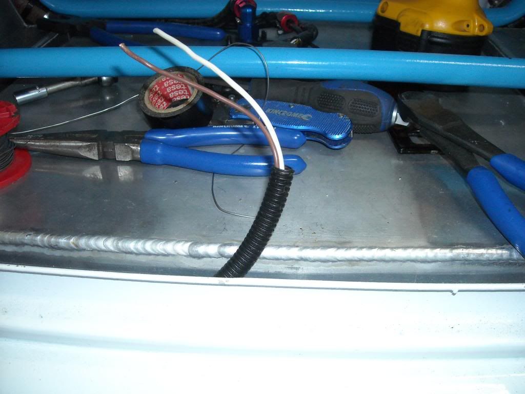

So, with the wiring loom rerun, and all taped back up, and the wiring count spot-on this time, I proceeded to fit-off the equipment that was able to be done. First was the windscreen washer pump - I ended up pulling this out of its grommet and solderig some fly-leads onto the motor connector directly and them terminating them into a male 2-piece connector. While it was out, I tested the pump in a bucket of water as it has three connectors - the third connector actually makes is spin at half speed and in reverse - this services the single washer nozzle on the rear windscreen, which I wont have. Once it was all terminated correctly - full speed in the forward direction - I reinstalled in into the tank, and terminated the wiring into the female 2-piece connector. Next to go was the main fuel pump - Bosch make this really easy - 5mm post for the positive with its corresponding 5mm lug, and 6mm for the negative with its corresponding 6mm lug - you cant get them mixed up, it just took some time to fit the rubber boots over the cables, fit the cable ends off, get my hands in there and put the lugs on, followed by the compression washers (both 5mm and 6mm), and then the nuts (again both 5mm and 6mm), and a good tighten with the 1/4-drive socket.
Cables run:
Main fuel pump and windscreen washer terminated:
Also done is a penetration through the floor for the windscreen washer silicon hose, which runs over to the drivers side and runs alongside the WMI hard nylon line (no pics).

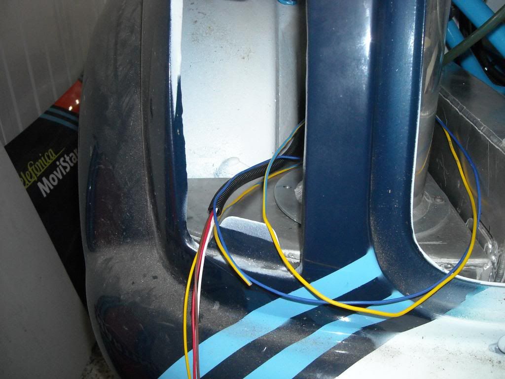

Next to be terminated was the fuel tank sender/pump unit. It has fives wires - two for the pump, two for the sender and an earth to ground the whole unit to the tank. Since it had its own connector, it was a basically just soldering and heat shrinking the correct wire on the plug to the correct wire on the loom. I them gave it some mechanical protection seeing as it will live inder the spare, and it was all done:
The only things left to do now are the tail lights, the boot remote release, the WMI pump and tank level sender and the boot mounted number plate light. I have decided to buy new tail lights - from the Mk 4/5 Mini in the UK, as they have a section in the tail light that is dedicated to the reverse light function, not doubling up with the indicators as we do here on our Clubmans - so the light terminations will have to wait. I also need new gaskets as well, so kill two birds with one stone there.
The light wiring is in position and ready to go:
I have also decided to change the WMI pump - I am going to grab a higher psi pump than what I have. The one I have at the moment is perfect for intercooler water spray or even large capacity W2A intercoler pump - but for WMI its really not up to the task. If you take into account the turbs will be running at 16psi the effective water spray pressure is only about 23psi (pump pressure absolute is 40psi) - the nozzles need a minimum of 25psi to atomise properly, so I have ordered a 200psi pump which, believe it or not, is not much bigger than the one I have and bolts up to the same mounting lugs on the tank. Should be here soon.
Wiring for the WMI tank level sender and pump in place:

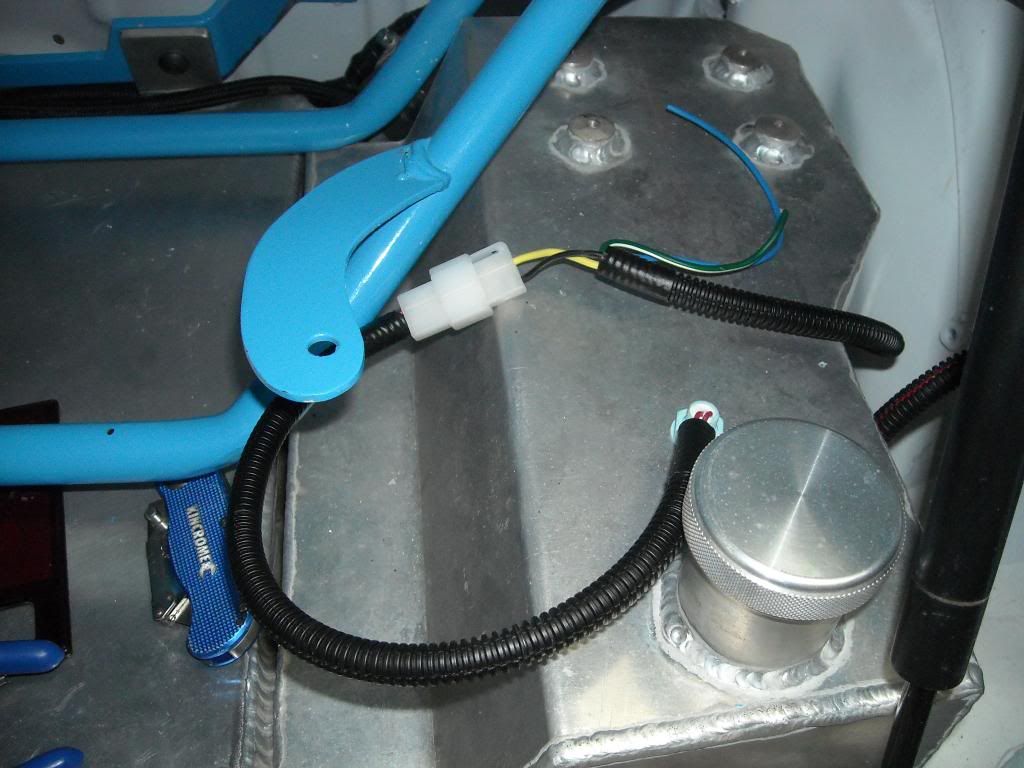

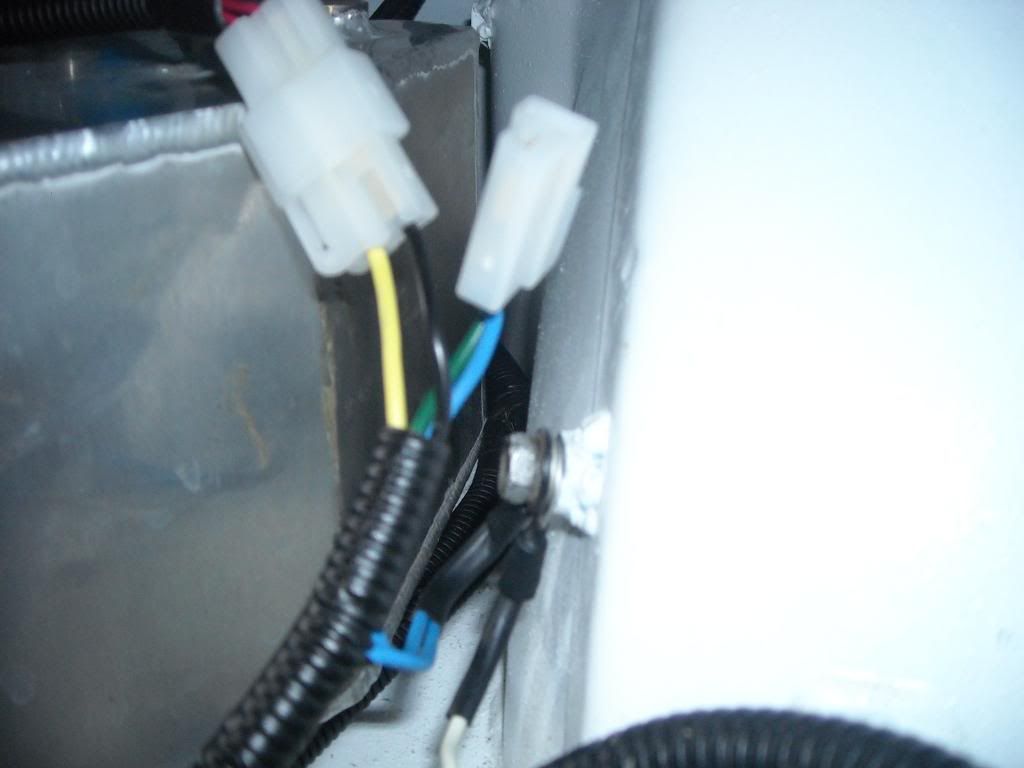

Fitted off the WMI tank sender unit - nothing special here, just used another 2-pin connector and some 10mm split conduit. Done:
While I was in this area, I fitted off the loom-side of the WMI pump - simply it was the same as the above, but only the female side of the connector, as the male side will be on the pump itself. Also in this area, was my earth point. This is where all the earths are tied to the body at the rear. There will also be a corresponding earth point at the front of the car - that way if an earth cable gets compromised between the back and the front (unlikely) it will still be earthed by at least one point. The blue is the common for all the pumps (4 pumps), and the white is the common for all the lamps.

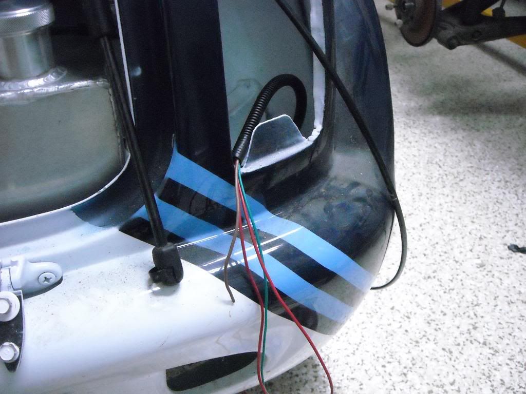

Last but not least, I ran the sub-loom for the license plate light, and left it bare until I decide what I am doing for a light (LED or standard Mini lamp) and until the boot lid goes back on.
