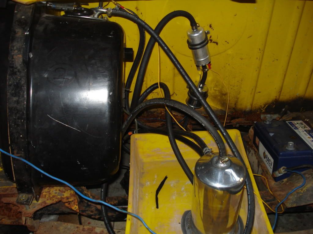

I got my fuel system temporarily fitted so i can fire the ol girl up, gotta make a bracket for the surge tank and pump. But it's all working fine.

With the placment of your filter, is that before or after the pump?

That filter you see is after the pump but there's another one before it out of sight

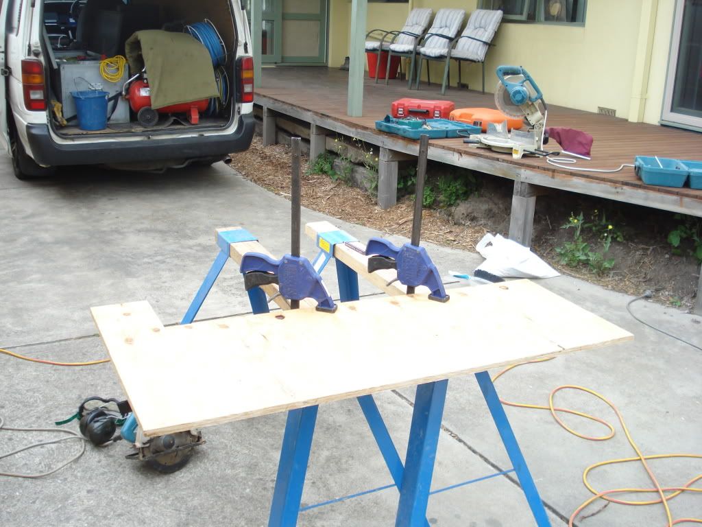

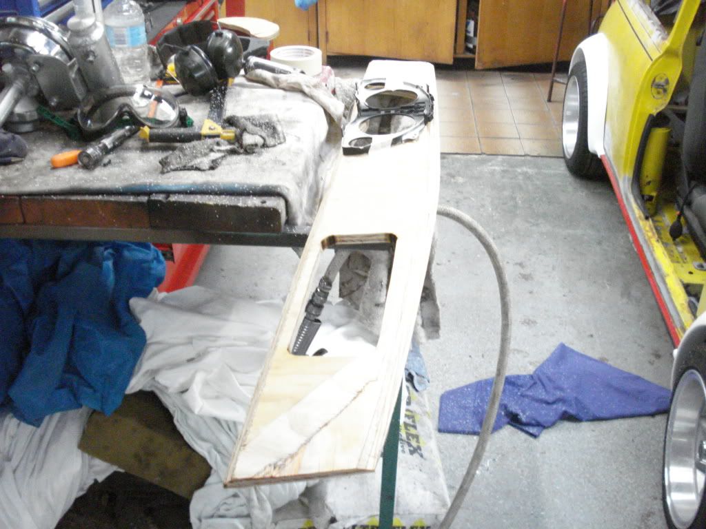

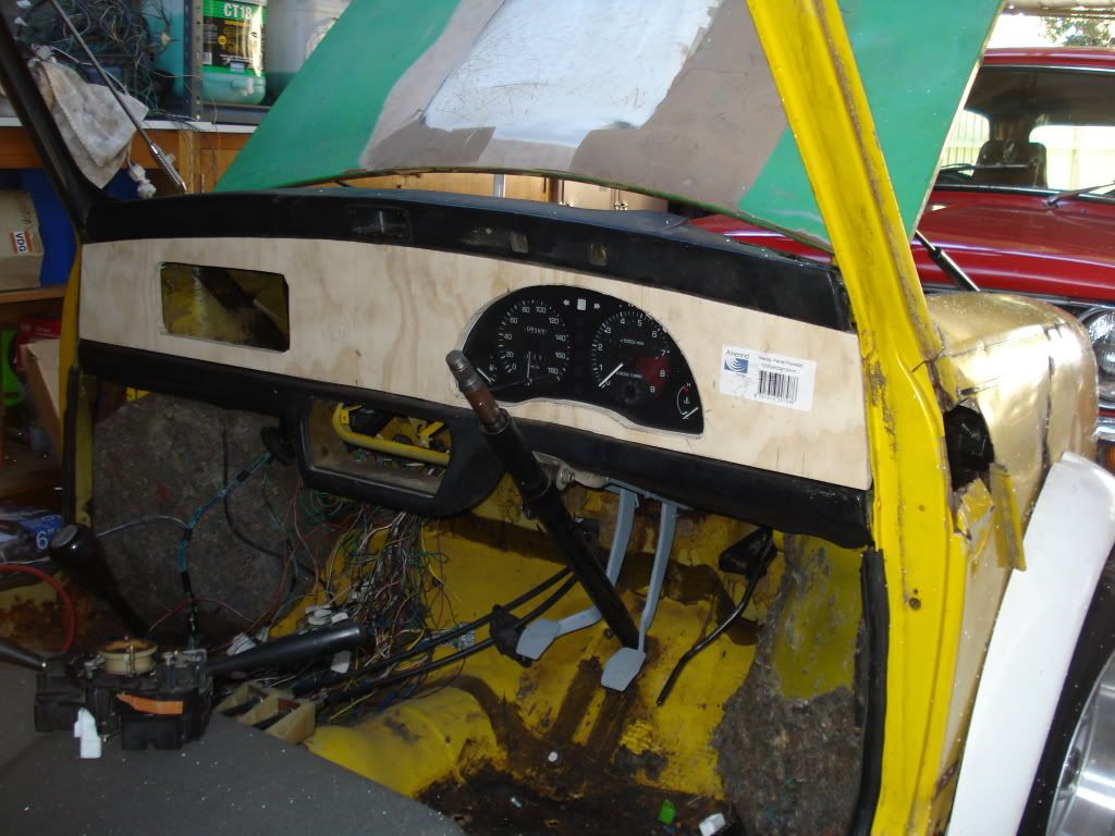

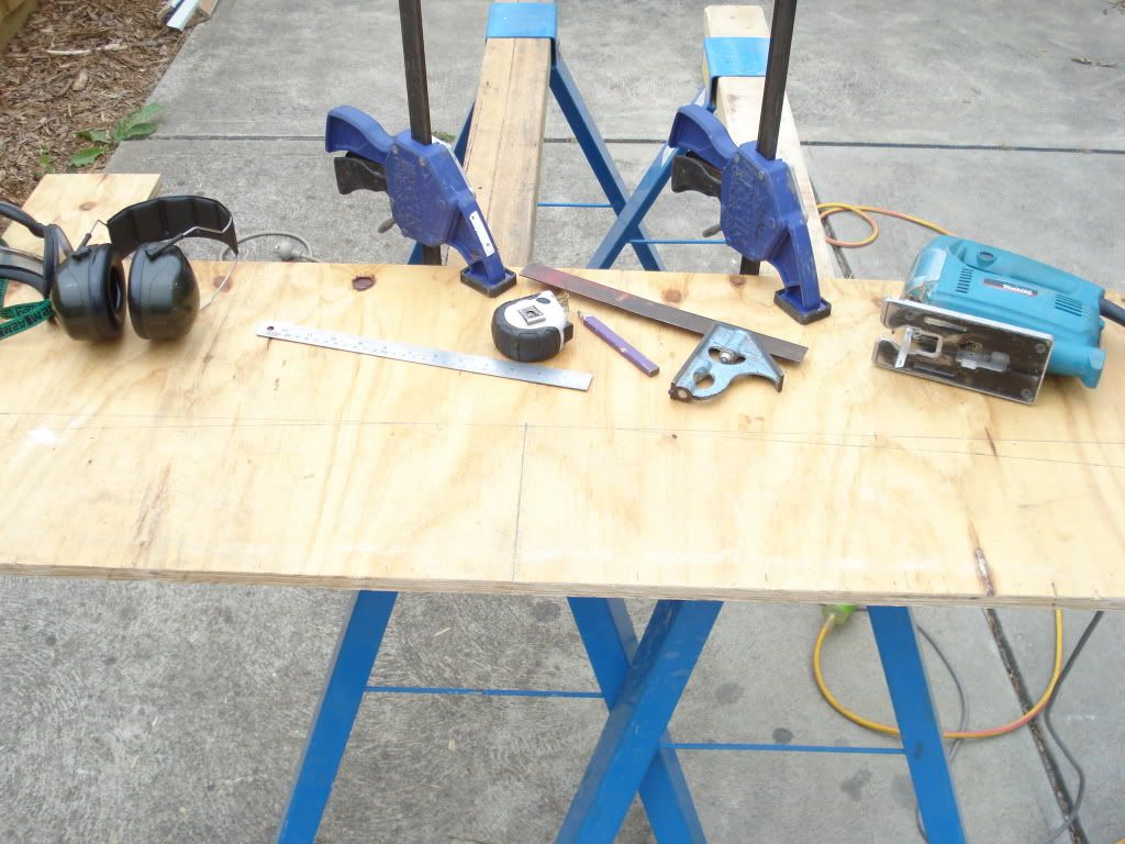

Well i've started the dash ,the first stage anyway
Well i should say i roped my son (a chippy by trade) to help with
the making
And cut some holes
And in the car

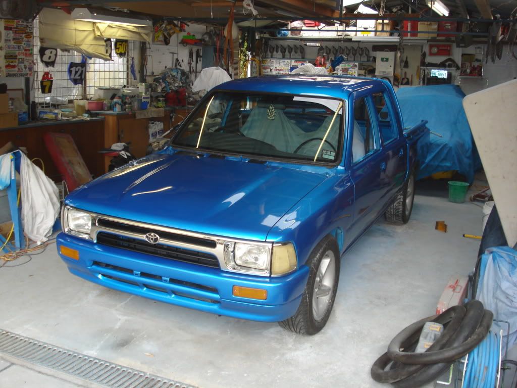

1st of all after years of " I must get around to that" I painted my
daily driver

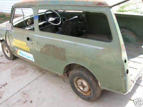

And i've also bought my next project DA VAN

That ute has come up awesome, well done. What are the plans for the van then??

Yeah ute come up good,looks a lot neater,

The dash looks good. How are you thinking of finishing it? Vinyl covering or paint or...?
That hilux came up a treat too. Yamaha blue? :P :lol: :P :lol:
