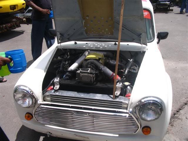

just found this pik i had....'
13b turbo......
