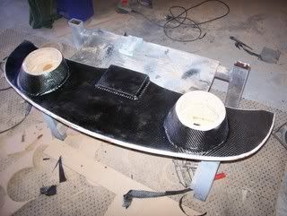

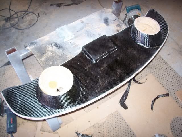

Just a small quick update to show you all what the (nearly) completed rear parcel shelf board looks like.
All the carbon fibre work has been completed, and all that remains is now to spray-paint black where the board is still showing through. This will make it look like one integral unit. Spaying black (satin black) at corners and edges is a very standard practice with C/F, because of its reluctance to form a round anything even remotely radiussed!
Then, its a case of applying the QBR logo, and a couple of coats of 2-pak clear for protection (UV protection - as epoxy degrades with UV, as well as mechanical protection).
I am yet to do the sub-woofer board, mid-bass enclosure, doors skins and dash.
Enjoy....................................

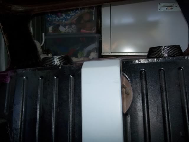

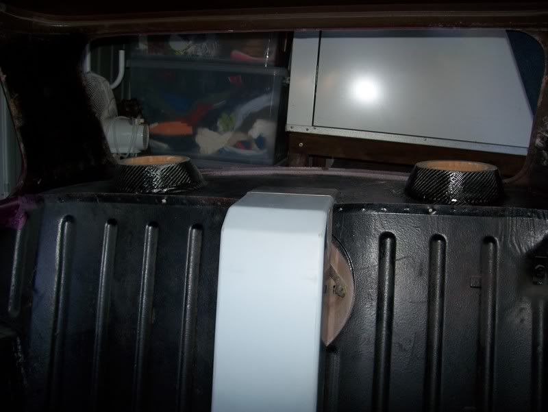

And in the car. Answering Smegger's question as to whether they will be too high, personally I dont think they will. Feel free to disagree of course. Notice how they follow the contour of the rear screen.

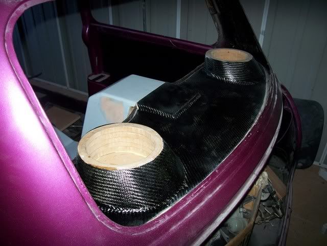

And the fit......................

stop showing off. Looks very good, what are your plans/layout for the door cards?
No problems there, looks great.
Getting closer! 8)
