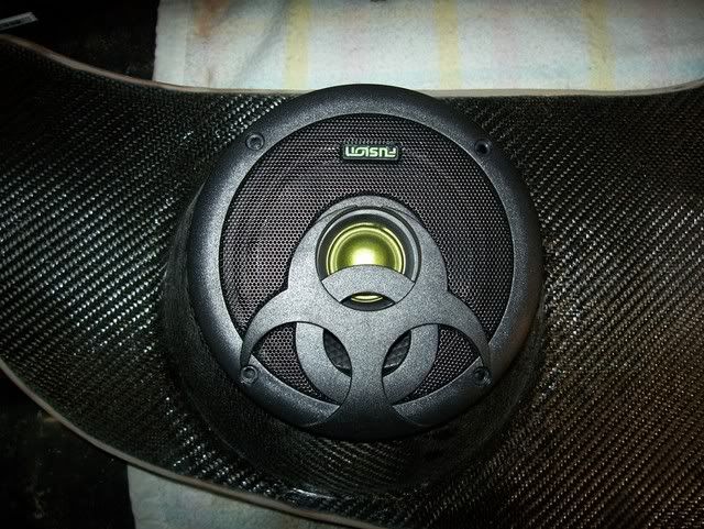

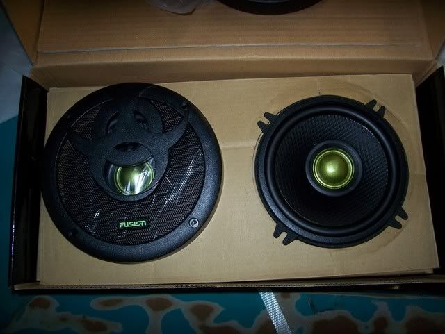

Just picked up my last set of speakers today, the 5.25" coaxials that go in the rear parcel shelf. And of course, yes, they are Fusion. Like I was saying before, they are all the same brand and same series (Fusion PowerPlant) so they should all be tonally matched.
This what they looked like in the box (nice big tweeter so should add some reasonable treble to the rear of the car):

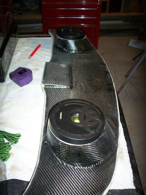

Couldnt resist having a play, here they are mounted in the rear parel shelf board:
Close up:

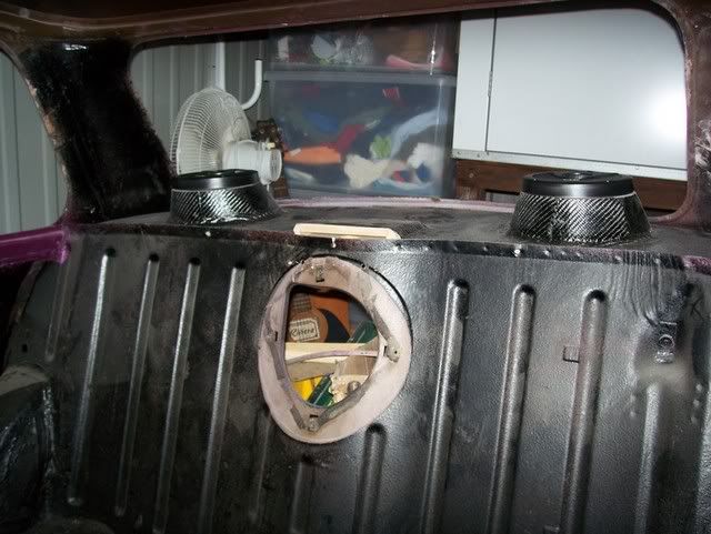

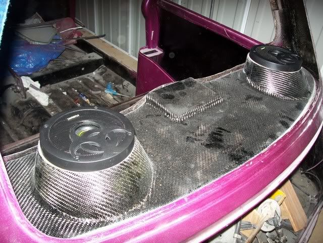

They dont look too bad. So I decided to test fit them in the Purple Monster (the mule) and see how they looked. This was the result:
What do you all think? Personally, I think I should have tilted them forward 15 or 20 degrees or so as they dont tie in seamlessly with the pods and continue that linear line of the pods. Comments!

I know what you mean about tilting them but I still think they look good. Everyone is still going to get an eye full of all the speakers running down the centre of the seat anyway.
I can't wait to see it all together!

they look great but as you said maybe a bit mor tilt next time.
just a short question, would a fibreglass panel work as well as the mdf for holding the speakers? or could you maybe smoothe out that edge with it? just an idea
Use a router to rebate the driver flush with the pods then create your own grill covered with black speaker cloth? Stealthy and sexy at the same time.

If you were going to run with a similar design id definatly tilt them next time...

I used the MDF as it was a solid substrate.
But, you could now use that as a plug, make a mould out of it, and then take a moulding off that.
As long as you laid up at least 4 layers of chopped strand matt, and at least one or two of biaxial or triaxial cloth, it would be just fine!
And it would look da bomb too!
