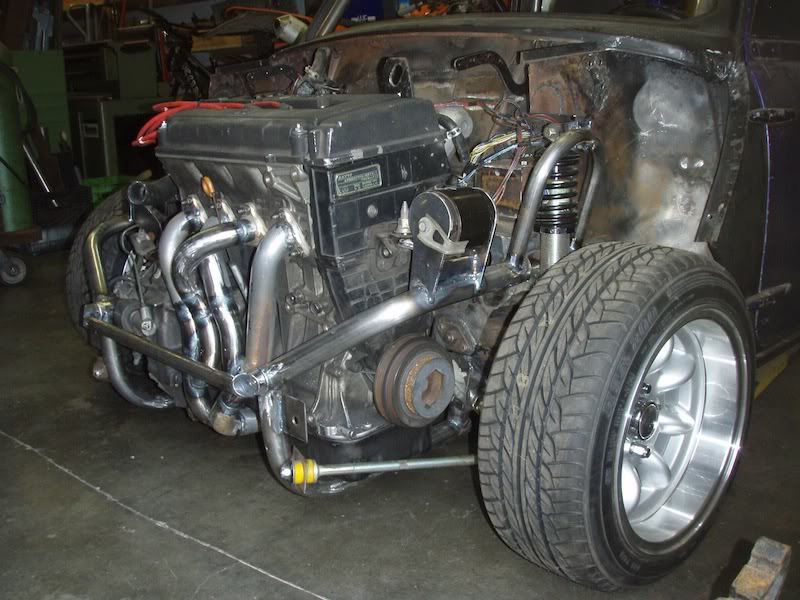

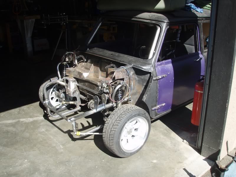

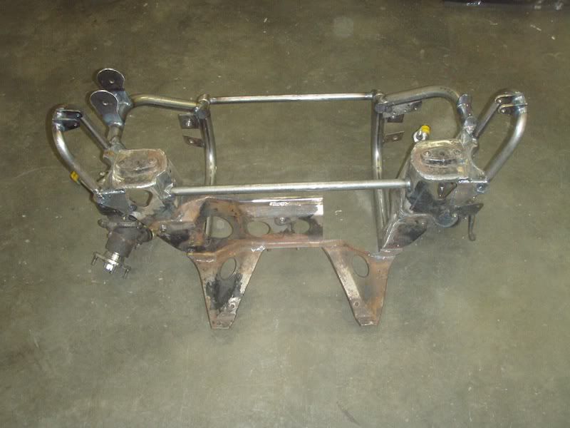

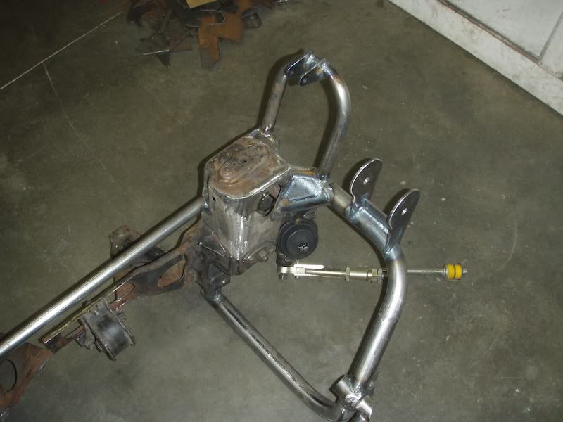

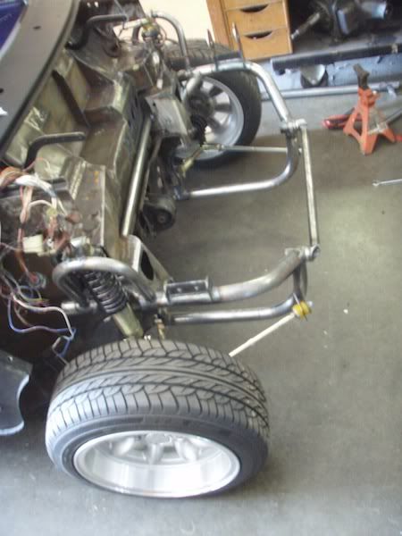

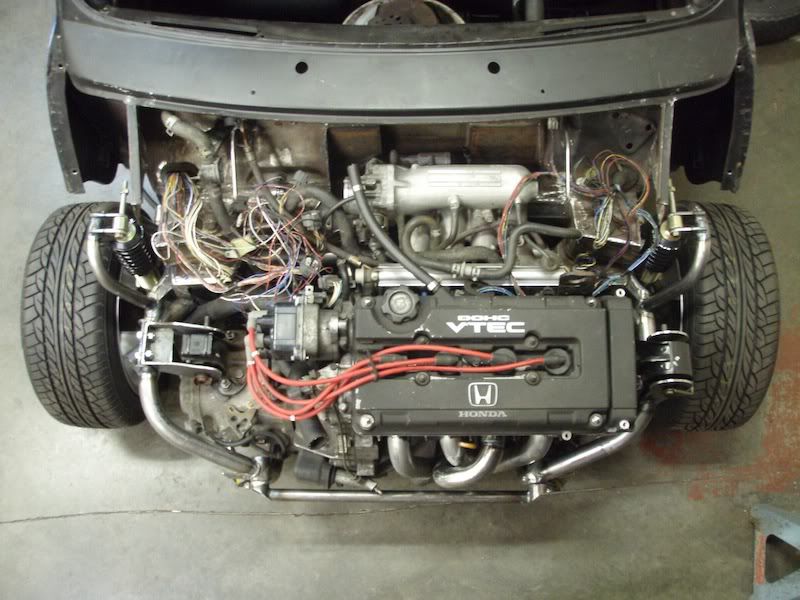

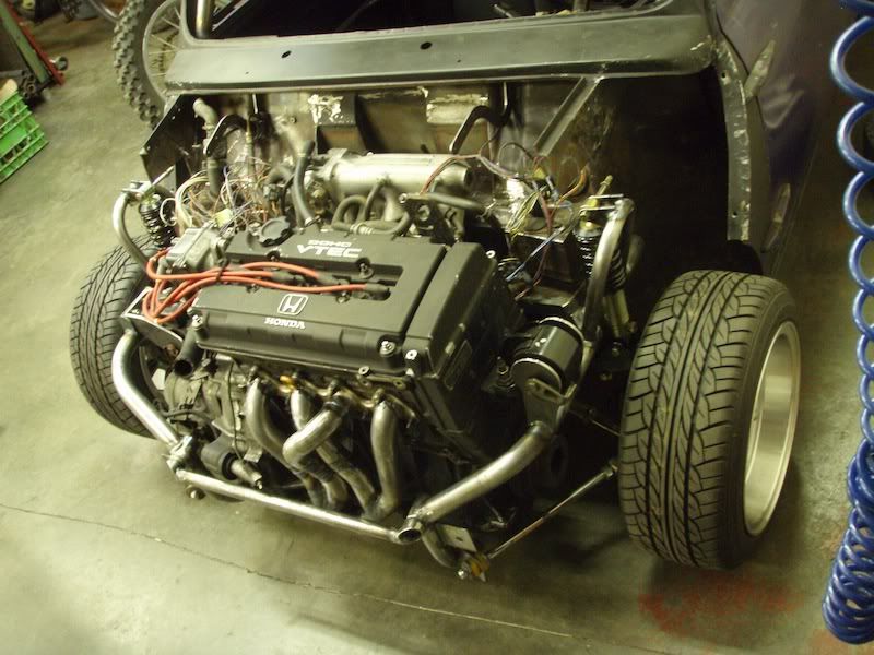

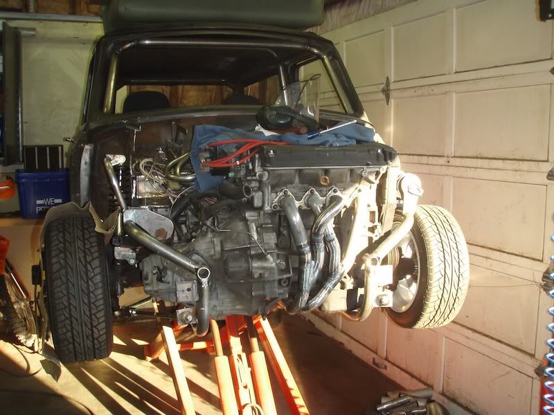

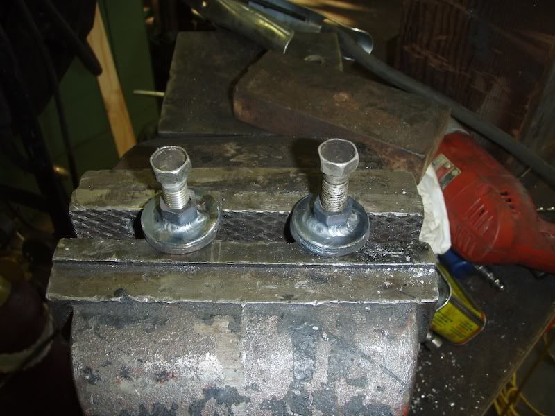

Well I did finish the header last week and I cut out the front tube of the subframe and made a new removable one so I will be able to take the header and the clutch slave cylinder off the car without pulling the engine. My design has the front horizontal tube behind the front bumper, there is room behind there for a tube, that is how I picked the height. There are two short tubes positioned longitudinally that I used for anchors at the front for the other tubes. Once I removed the front tube I welded some metric nuts to the back of some circular caps which I then welded into the short anchor tubes. This allowed me to construct a new horizontal transversally mounted tube for the subframe that I could remove. I will be pulling the engine soon to finish up the welding on the subframe and give it a coat of paint. I will be painting up some of the bare metal to seal it off pretty soon because I am going to have to move the Travelle"R" from my friends garage soon as he needs it for a few weeks to do some work of his own. So it will be back at home in my portable garage, so I don't want it to rust up, especially as it is turning to fall here and there will be a lot more moisture in the air. The good news is that it will be more convenient for me to pop outside and do some work whenever I have a little time.
Here are some pics.
Header done with front tube cut out of the subframe.
Caps with captive nuts TIG welded on.
New removable tube bolted on.
Couple more shots to show the little clearance there is between the front tube and the header and clutch slave.

Question: Do you plan to reinforce the caster arm mounts at the front of the subframe?
All the braking and acceleration loads are transferred to the chassis through these mounts, it appears in your photo's that they're not going to be strong enough.. ?

You didn't really think I was going to leave those that way did you? I'm just in the middle bracing up the subframe and welding it up. I'll have some more pics soon.

Maybe I have missed it, but what sort of alternator are you planning on running? Will it fit between the block, headers, subframe without fouling when the engine rocks?

pigsfly - I am going to use the stock Honda radiator flipped backwards on a mount up near the top motor mount. I am also going to use the stock Honda tensioner pulley on a custom mount so the belt can run around where the motor mount bolts to the block.
edit: I should have written alternator, not radiator. I do know the difference, but I got side tracked at work when I was typing this post originally.

i (believe it or not) don`t actually mind the way this subframe is progressing
I normally would bag the crap out of (most) of the jap conversion subframes that i`ve seen so far, & yes i have some concerns with a few fiddly things/designs on this one too,,, but i`ll reserve my judgment till we see the finished/braced article
lookin good so far , keep up the good work i say :-)
