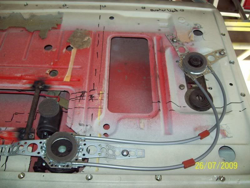

This is the winding mechanism and motor drive installed. Some cutting was required.

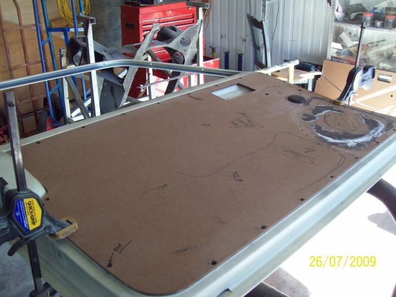

With the door card on:

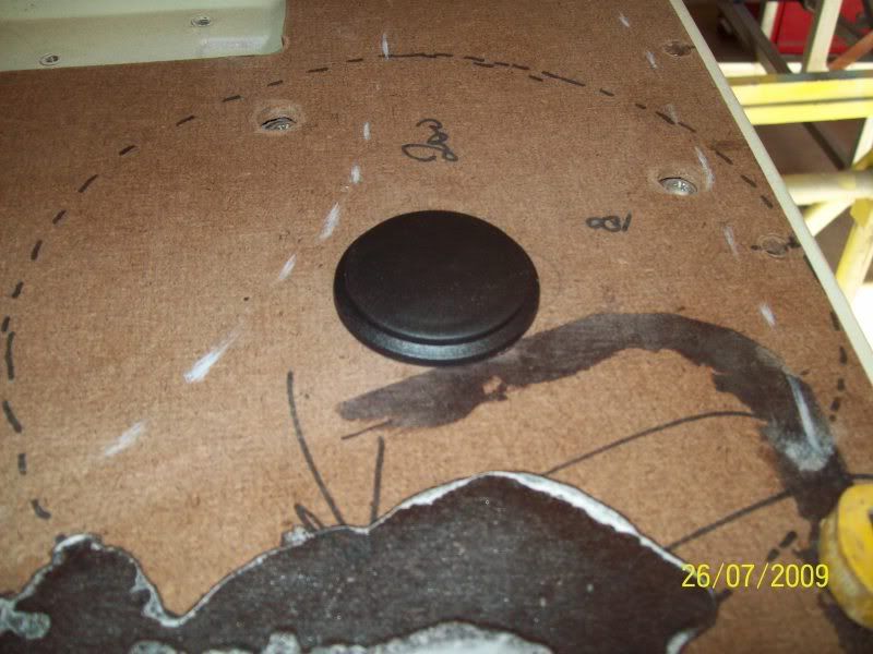

The winding machanism was almost flush with the door card, but not quite.
So, a small cap, which is suuplied with the kit, is used to hide the winder shaft' This will be painted the same colour as the door card so it will blend in.
Does the window go all the way to the bottom, or is it like a ford fiesta: just a little bit down? Looks like the motor is in the way of the glass, and I'm guessing the window would be 80mm or so from the bottom?

Hi Harley,
No, the motor dos not foul the glass at all.
I laid the glass on top of the door, and drew the outline of the glass on the door so I would get an idea of where it was frre and where it would interfere. You can still see the black felt pen marks on the door, where the outline is.
It took me as long to work out where the motor unit would go, as it did to actually install the whole mechanism.

MM,
They seem pretty gutsy to me.
Their is a big reduction gearbox on the motor end, like about 20:1 so they should be able to power quite big bits of glass. Remember too we have the added assistance of the col-spring when winding back up.
