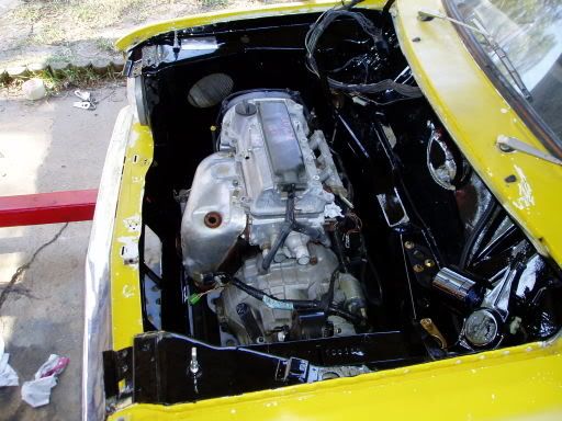

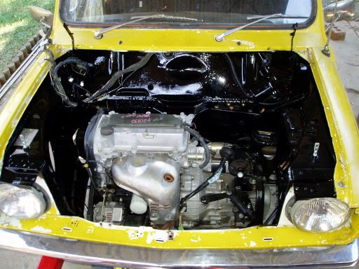

finally got the motor in last night :D :D
very happy theres heaps of room for the radiator and other parts + the drive shafts should be back soon so its all starting to come together
:D :D :D :D :D :D :D :D :D :D :D :D

How freakin small is that motor! :shock:

989cc of diahatsu power :lol: :lol: :lol: :lol:

much power/economy increase? you have dropped a cylinder yeah?

yes its a 3 banga was one of the most fuel effiecent motors in 2000 its only around 65hp standard but its 50kgs lighter than the 'a' series ,so it should move along nicley

It actually makes a Mini engine bay look huge! :shock:

Any plans for performance mods, or is it staying 'stock' ?

definately running forced induction next year either the same type of supercharger as i had on the 'a'series or a toyota CT9 turbo that a mate has
because it is still registered i want it to have no trouble getting engineered so im using everything i can from the sirion
+ i will have 6 to 8 months to get a feel of the car and sort any little problems it may have

Did you have to cut the inner gaurds at all? And would this fit in a round nose without to much trouble?

the only thing i had to cut was a piece of metal below the master cyl's that the engine steady conected to, there is heaps of room on both sides between the gaurds and the motor
in a round nose the sirion radiator would fit at the front also

i really like this conversion. seems alot simpler than 4efte. I know the power isnt anywhere near as good but fora daily driver that is reliable it sounds great. my daily driver is a 3 cylinder at the moment.... the mechanic said it will soon be a two and then a one ( it was a 4) but its is dying a slow death. hehe.... car cost 800AUD so i dont think I will get a new engine for it.
can you mod this engine much to gain extra oomph?

with forced induction im aiming for 100hp ,with all the bolt on goodies for late model efi engines it shouldnt be that hard
