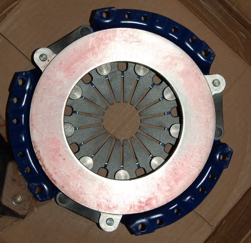

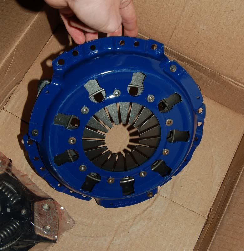

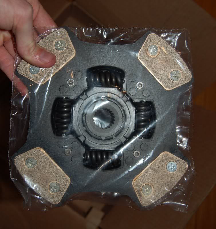

Yeah I don't want to have to replace this clutch again any time soon so I think I will go something like this. Yeah I looked at a Adaptronic which was my other choice, given your statements I might go that way especially as I know they have previously done a 4EFTE... And yes it should go like bullet after the engine mangement and clutch is sorted...
By the way my pedal is pretty firm will something like this make it extra hard?

Comparing my pedal now to what it was with the Exedy it's a bit harder, but i wouldn't say too much - it's personal opinion though, I actually like a tough clutch with some bite nothing worse than a slippy clutch, then again it's not a daily driver anymore and if it was it would probably crap me. Just about everyone who has touched the clutch has gone "WTF!" :lol:
