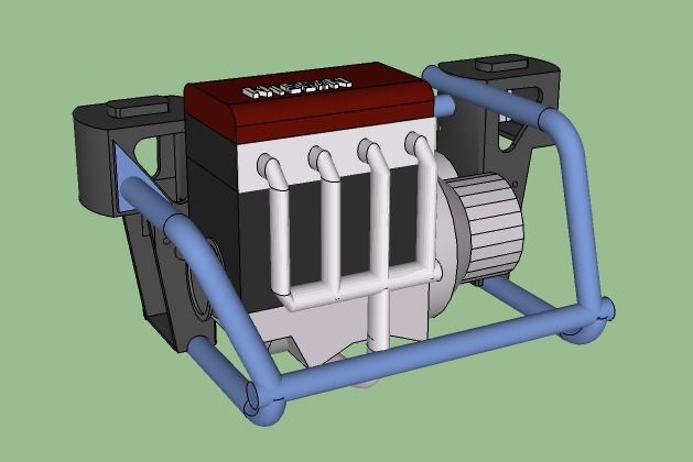

I have a CG13DE conversion in the works.
Yes, a Nissan micra 1.3.
This seems to have been a hotly debated topic about the worth of doing it, the way I look at it:
It's 100hp ATW
It's lighter than an A-Series
fits without cutting the body (this is the big one for me)
5 Speeds blah blah
I haven't got the motor yet, but I have been doing a lot of research, it's quite popular in the UK.
The UK produces some, 'interesting' engineering when it comes to subframes.
After the recent discussion about the 4EFTE subframes that hang entirely off the towers, I got to designing my own from pictures of british ones.
Here is what I have:
Nothing here is to a particular scale, but I drew it freehand and tried to keep it to correct-ish dimensions.

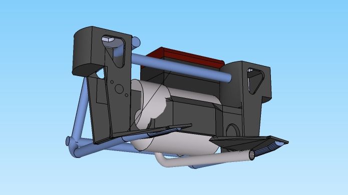

Drivers side top spar:
Will have a thick spreader plate, covering as much surface area as possible to spread the load.
Loops around to the front bar, and back under the subframe all the way back to the pick up points on the body. This seems like the sturdiest way to do it.
Passenger side top spar:
I don't want to cut the body, or rad shroud, so it's welded along the inside of the turret (like nigel's vtec frame)
Same as the other side, picks up the front and all the back way to the body mounts.
Between the tower is braced.
You'll also notice the diff on the motor (excuse the crude model) sticks through the web on the back, so it obviously has to be cut around.
I was thinking a good way to reintroduce some strength into this area would be a second bar between the towers, welded along the top of the webbing. Then bend it up and over the diff to meet the top bar.
Could also weld either:
A. Thick plate between the rear 'feet' that bolt to the body, to regain strength
B. Similar to Josh's 4EFTE subframe, weld a bar between the two holes on the rear feet (forgot to model those, oops)
C. Bend a weld a tube to the inside edge of the rear feet, all the way around.
Any opinions and criticisms are welcome, as it's obviously still in planning stages.
Needs more gussets and things, so feel free to mention where you they need to go.
SimonK, wouldn't mind hearing your opinion too :wink:
You're so square
Baby I don't care

Your frame design is right in having it connect and run underneath.
In what world does a CG13DE make 100HP ATW?
Everywhere i read put it at factory 58Kw or 78HP...at the flywheel which would put it around the power output of a very modest 1275 or very worked 1100. I'd say around 55HP ATW, not exactly earth shattering for the effort.
5 speeds doesn't work out as a massive advantage on the highway usually unless you change the final drive. You just get a wider range of gear selection and a short 1st gear.
The effort/cost of building a subframe, cost of engineering, cost of engine are not outweighed by the fuel economy, 5 speeds, reliability IMO. There are new laws governing conversions in NSW as well which put further hoops and cost in place.

Remember that you have to fit, intake, exhaust, radiator, alternator (important as they usually point the other way) all the associated wiring and fuse boxes and being a post ADR car probably a booster etc, etc. what looks like a straight in with no mods always seems to not work out, if your doing it in a clubby it does make life slightly easier I guess. Having driven a few micras though I'd be looking elsewhere, they feel like driving a desk fan so make sure you know you can pull power out of it before spending 10k on a conversion.
Frame looks about right, although I'd ask and engineer and be careful about what information you get on here as perfect world situations people seem to ask for aren't always achievable when you start building it!
But, don't let me stop you, all I want for my engine conversion thread is encouragement so good luck with it! And if you want to do it, then do it! Your car after all :)

@Josh:
I don't expect it to be a rocket ship, it's no 4EFTE, i'm under no disillusions.
If I was after amazing power, this wouldn't be the engine for it, no. If a CB70/80 becomes available, let me know. I'll happily go that route instead.
Depending on the dyno/engine condition/state of tune, people on the micra forums are getting 75-95hp at the flywheel on stock units.
MrFail is right, they are very strangled by intake and exhaust.
I don't want to start a debate on whether or not it's worth doing, but it seems inevitable.
@Meeni
I understand all that needs to be shoehorned in there. As I said, it fits, with no body mods. People have been doing it for years on TMF. Only body mods are a result of bad execution of the subframe.
Not sure if my car would require a booster, never left the factory with one. If the engineer says it needs one, then it will get one.
Happy to look elsewhere, if there is another option that fits without too much hacking about. Couldn't find much info about how the G13B fits into a clubby front, but I did hear their power band is quite high up..
Speaking of power bands, the CG13DE makes it's torque from 2500-8000, seems like a good power band for a daily to me. The micra's I have driven seem to pull quite well in any gear.
But i'm happy to be swayed to another motor.
Thanks for the encouragement.

From someone who has done a conversion and been involved in a lot of other conversions on here IMO it would not be worth the effort even completely dismissing the power output. My Ex GF in highschool used to drive a micra and it's not that great an engine and relatively old if you were going to go down the modern efficient route.
Talk to ben (ausminis4u) about what engines are readily available in japan. Anything is available if you look hard enough for it - including CB70's
A very basic break down of costs and estimation:
Engine Cost: $1000+?
Intake: $300
Exhaust: $500
AirFilter/Box: $100
Fuel Lines: $300
Fuel Pump: $300
EFI Tank: $300
Subframe: $1500
Brakes: $1500
Wiring/ECU: $1000
Gauges: $300
Engineering: $1000
= $8,100
And there are lots of other hidden costs that i havn't taken into account. What about insurance costs?
For me you could spend a lot less on an A-Series rebuild which you can tailor given the same bore-stroke with a nice camshaft and headwork to make similar power and be fuel efficient if that is the brief.
hell you could buy a whole late rover EFI for a little bit more and that's a whole car and they drive very nicely and make lots of torque from 1,100rpm.
Anyway it's your choice and if you want to do it go ahead, i'm not trying to stop you, rather give you advice from my experience. There are very few people who have actually completed a conversion (JC has a lot of experience here as well) and i'd be talking to those who have the experience rather than the general masses who will tell you to just do it because.
You have a lot of knowledge available here - if you keen i'd be going in a 4EFTE conversion, brad's CB70 conversion will be done soon, drive a EFI rover if you havn't already and a well built 1275 for economy. Why try and reinvent the wheel?
