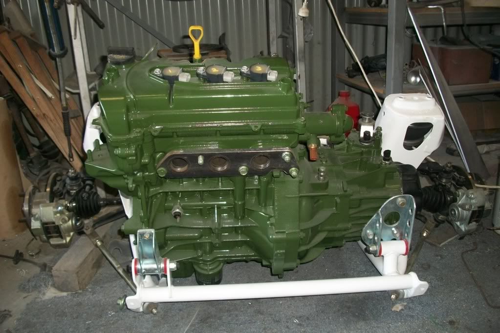

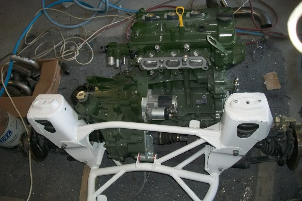

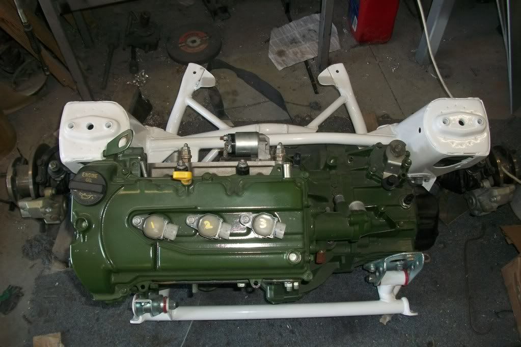

Hi,here are some pics of my mini project. Suzuki k10b engine in custom subframe.

Looks like a nice subby!
What sort of power does it put out?
And how much does the block weigh?

I like the frame, be interesting to see how that motor goes I don't think I've seen anyone do it yet, actually looks fairly similar in size to the g13b

Hi Adam, in standard form the engine makes 70ps@6200rpm and 90nm @3500rpm which isn't to bad considering it is tuned for economy.I have triumph triple throttle bodies and megasquirt and free flowing exhaust. Engine and gearbox is 50lbs lighter then A series as it is all aluminium.

Man that's one offset diff!
Oh and somebody flogged one of your spark plugs....

that's a really really neat subframe :D

Hi Smac, engine is offset so l don't have to modify the standard 62 mini body(inner guards), I am hoping it doesn't have to much torque steer.Matt can you tell me the year of that suzuki
