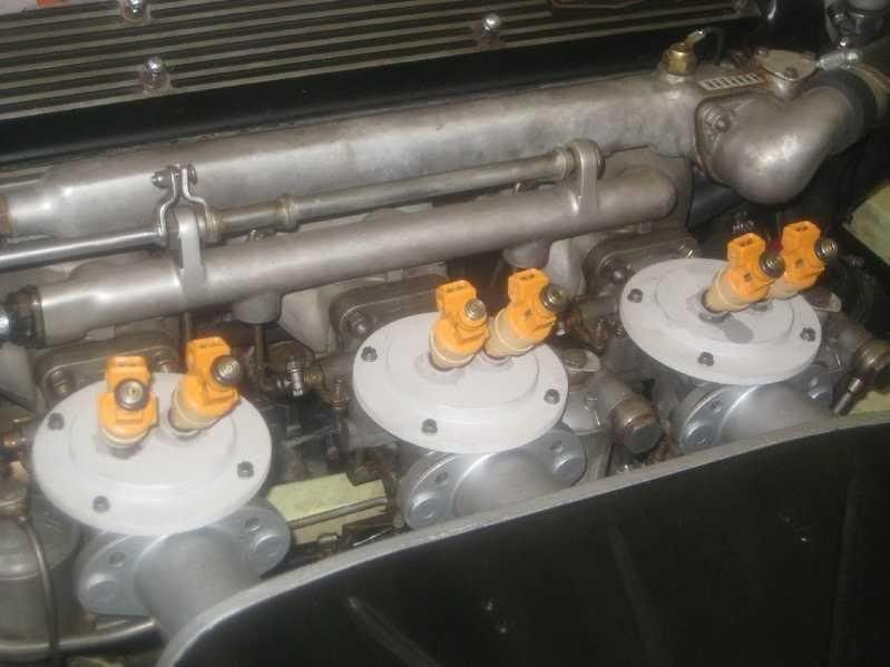

Looks interesting
I see no reason why this cant be done for any su all you would need is trigger wheel on the dizzie (pulsar??) and basic fi system.
PostPosted: Sat May 02, 2009 12:54 pm
& throttle possition switch,
PostPosted: Sat May 02, 2009 12:58 pm
TPS is not required, but you do lose some of the benefits of an EFI system sithout it, i.e. cannot compensate for throttle lag.
PostPosted: Sat May 02, 2009 2:34 pm
Why bother with 3 siamese intake ports on that poor Jag, get a 6 port manifold and do it properly! :P
DCOE style injection bodies... :wink:
PostPosted: Sat May 02, 2009 2:54 pm
Posts: 11749
they never made any - its easier to use the off the shelf bits
PostPosted: Sun May 03, 2009 11:36 am
TPS is easy to add, and use a crank trigger wheel & megasquirt...
not pretty, but I guess it works - a loong time ago I thought about doing similar, but I'd want put the injectors under the carb where the jet is, so you can still have a dashpot and make it look standard-ish - that looks ugly!

Weld weber flanges to a 6-port manifold and fit custom throttle-bods from EFI Hardware in Mitcham. Looks great, no grief, great airflow and comes with a TPS fitting kit.
There's a company (I fogott the name) which did exactely that. Standard looking SU carb, but full of electronic goblins and injectors. Looked realy cool. Shame I forgott about the name :(
