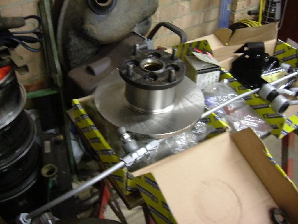

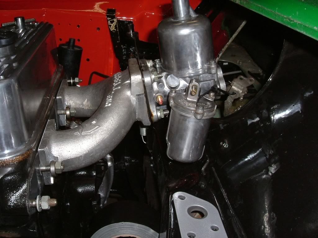

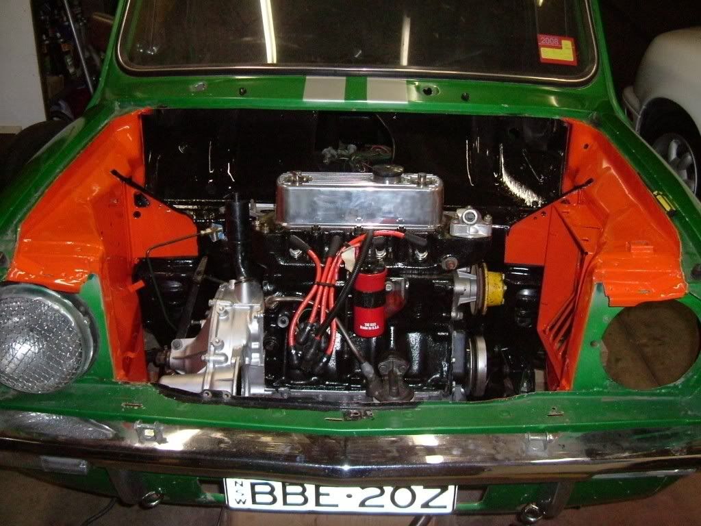

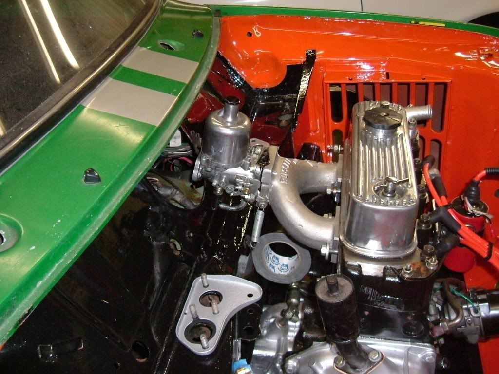

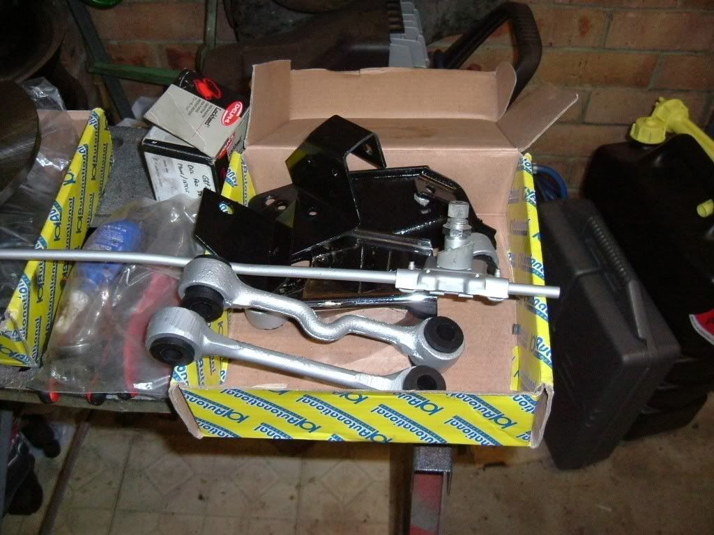

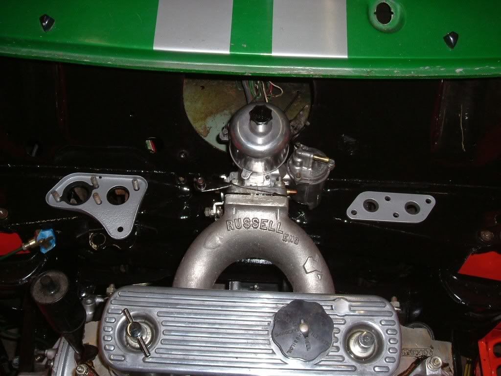

Well the engine is in, almost, I was hopeing to have have the top engine steadies in and have a start on the wiring this weekend but I spent most of the two days finding the right bits and pieces , cleaning and painting them, The bad news is that the SU hits the firewall... :cry: , only just!, the jet bridge just touches the wall, so i'm thinking that the right sized hole saw should fix that...I'll see next weekend.
Just some of the bits and pieces that I'm getting ready.

Have a chat to GR and check if you can angle/mill both the carby side & the head side of the Inlet manifold to raise the Carb

You may want to attache the engine steadies before you modify anything with the carb. It might just be that the steadies will push the engine away from the firewall and give you the clearance you need.

and if you do need the clearance, i would use the right size hammer rather than a holesaw :wink:
PostPosted: Tue May 06, 2008 9:27 am
ditto to the above.... put the engine steadies on, and talk to GR about whether you should use a hammer or the mill...

Yeah, thanks for the advice guys, I did fit the steadies to check the clearance before I panicked...... :D , I still just might use the BFH. The wiper assembly is the next job for sure.... :D , I'll let you know how it turns out on the weekend.
